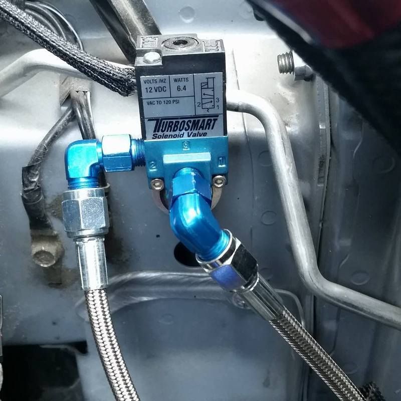

I went braided stainless, not cheap when you compare to the by the foot stuff but way cheaper then the problems can can follow a failed line.

Like mrk1 I went the AN fitting route but didn't use braided, just push lock hose.
