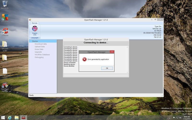

I am still getting these error messages, although I was finally able to write roms and upgrade my device so I don't know what is going on.
This error is caused by not having a WIFI connection. You can click OK and continue to use OpenFlash Manager. It just won't apply updates to the OFT.
