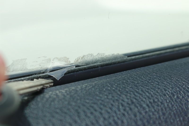

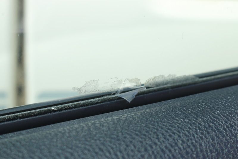

Took my 86 to wash, still making huge noise. Not even a little improvement. Also the driver side window is over loose. Window shakes when every time rise it up or down.
20/06/2015:
5pm, 17hrs after car washed, still making huge noise. Window isn't installed at right position, window tinting has been ripped off.
