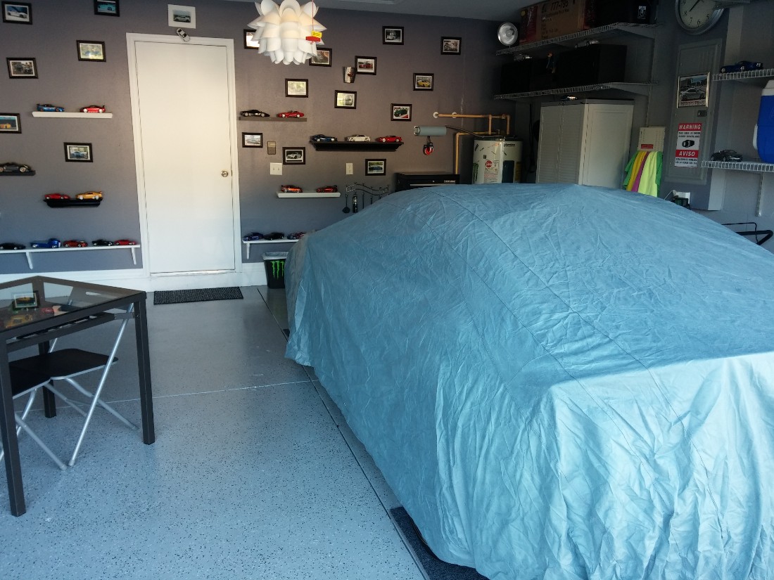

yea I keep it in the garage all the time and only take it out around the block one time a month for like 5 minutes to run the fluids...

Attachment 110727
kind of like I do... I drive it for like 15-20 minutes though
Attachment 110727
Why?
and beautiful garage
Attachment 110727
HOLY CRAP!
That is nicer than my living room. I am not kidding here!

Originally Posted by BlueSky View Post
Why?
I got another dd and this one is like my toy and for now im just adding aftermarket parts...
Thank you..
