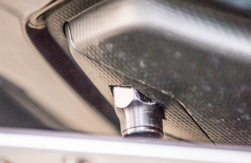

Here is an image of the cover I cut:
I used a razor blade and some small drill bits.
