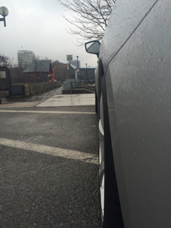

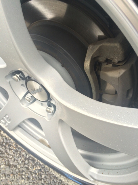

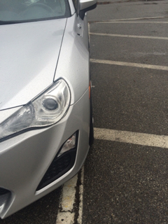

Hello. I got some summer wheels and tires for my FR-S. I bought them and had them installed at TireRack. I got 18x8.5s with 235/40 tires.
They seem to look pretty nice but I got a problem. Rocks are getting flung up onto the door. The tires are poking out of the wheel wells a little. What can I do? I can't tell if there is a spacer or not. There is no wheel rub in front. Even if a spacer is used then if I move it in I might create rub.
Any suggestions? Anything from fenders to rock guards to fitment is welcome. Name:  ImageUploadedByTapatalk1428013599.765710.jpg

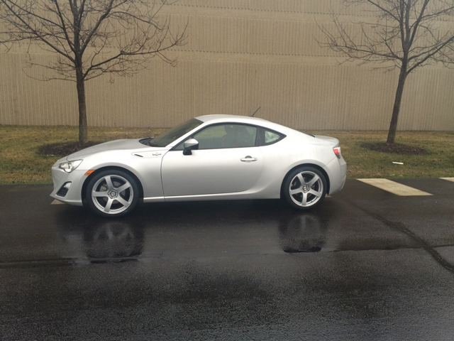

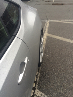

Here are some more photos
Back
Front

Troll? Your wheels look perfectly flush front and back?
Mud flaps would help, but that's a pretty distinct look so be sure you want to go that route.

doesnt look like you have spacers installed... it just looks like wheels with a slightly lower offset. with 8.5" width wheels, im guessing your offset is around the low 30s for it to look like that. if you're concerned with that amount of tire going past the bottom half of the fender (which honestly is not that much), then your only other option is to switch to wheels with a higher offset to tuck those back inside more... or just drive on roads that arent as gravel-y
