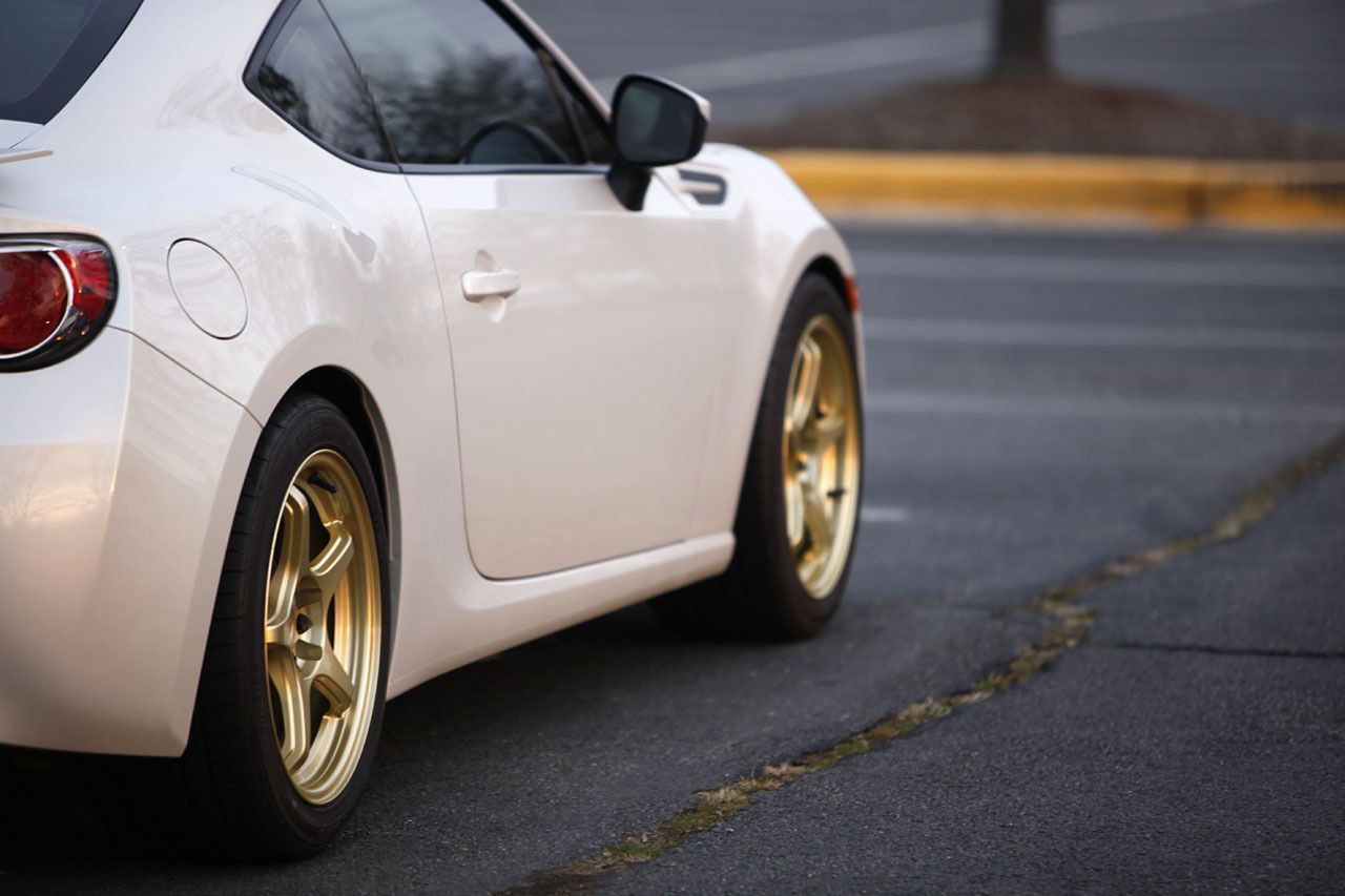

Mach V Dan
FT86Club Official Vendor
Drives: 2013 BRZ, 2015 WRX, 2000 RSTi
Location: Sterling, VA
Posts: 597
Thanks: 6
Thanked 408 Times in 192 Posts
Mentioned: 27 Post(s)
Mach V Dan is offline   Reply With Quote

@Mach V Dan I know, I know - it's a great option and right now a toss up between your wheels and the RPF1. Can you confirm: AP sprint kit fits, clearance with lowering springs and stock dampers or konis and camber bolts maxed out?

Originally Posted by Amadeus View Post
@Mach V Dan Can you confirm: AP sprint kit fits, clearance with lowering springs and stock dampers or konis and camber bolts maxed out?
Yes, the AP kit fits.
245/40R17 fits easily. The car in the photo I showed above has 255/40R17. The car is lowered on our own Mach V springs.
--Dan
