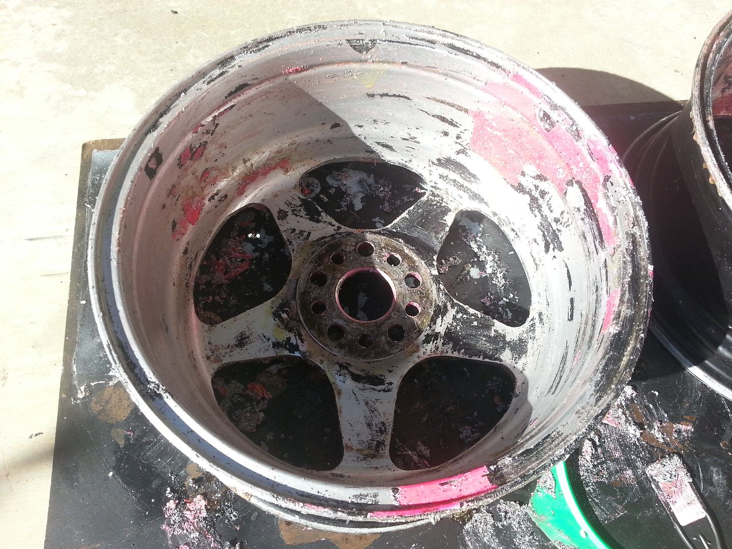

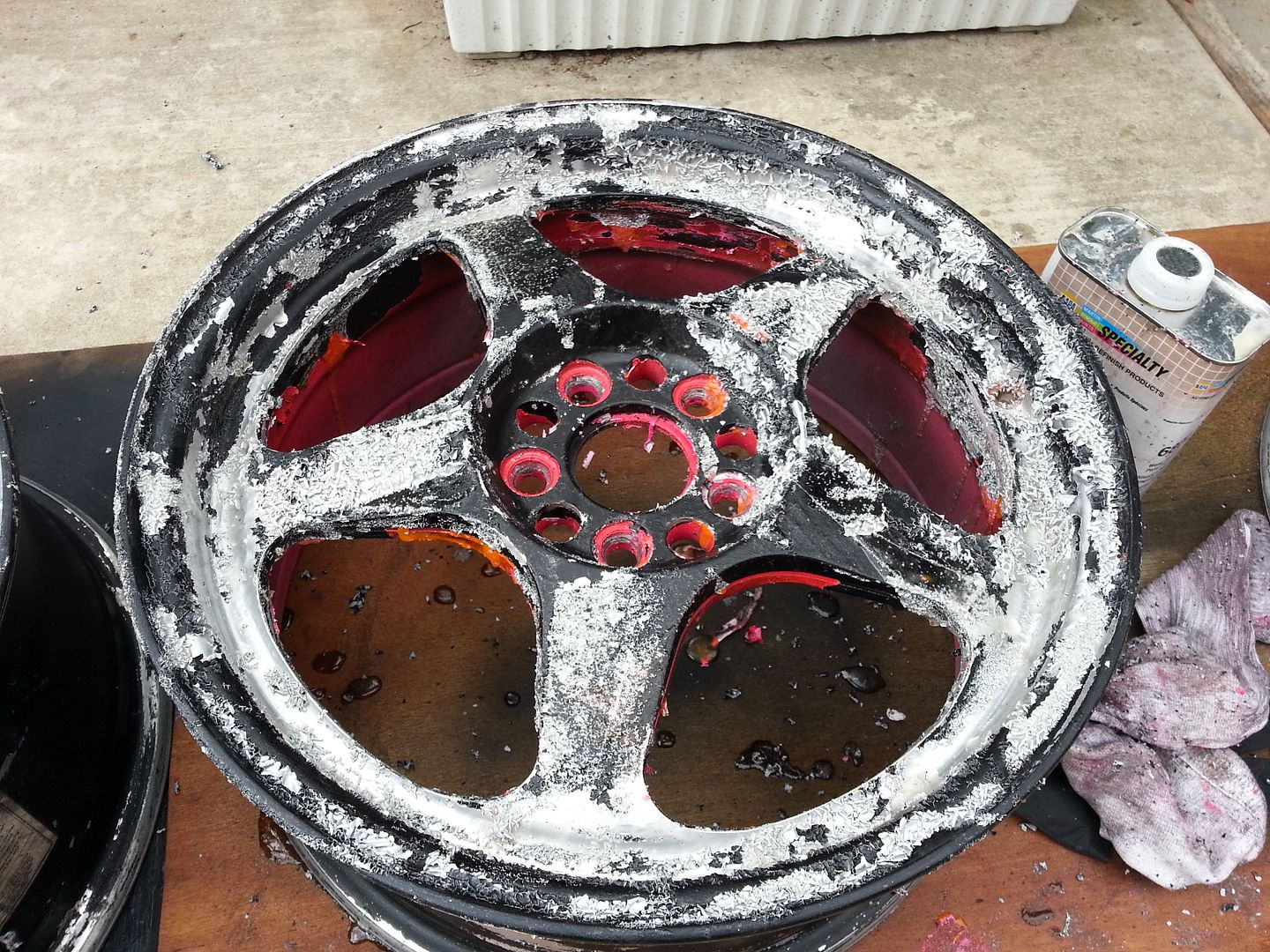

I was like "Wow! Same wheels, and it looks so easy!". More searching and some time later, I bought some paint stripper from Napa Autoparts... Tried it last weekend, and it didn't go so well! You need to put it on THICK not thin, and it works, but I used a whole quart and it barely took off anything from the outer spokes:
So I did more searching, realized that the RIGHT stuff to use is the "Klean Strip" Aircraft paint remover, and you need a GALLON of the stuff for 4 wheels and put it on REALLY heavy! (Its a Gelatin like substance, so keep it thick and apply generously)
You do need to be VERY careful with this stuff! Use cloths you don't want to keep, wear kitchen gloves ON TOP of some rubber gloves, wear a mask, don't get it on ANYTHING you don't want it to be on. It stinks for sure, but Brake Cleaner is worse in terms of fumes. Its also water soluble so its actually not to hard to clean up.

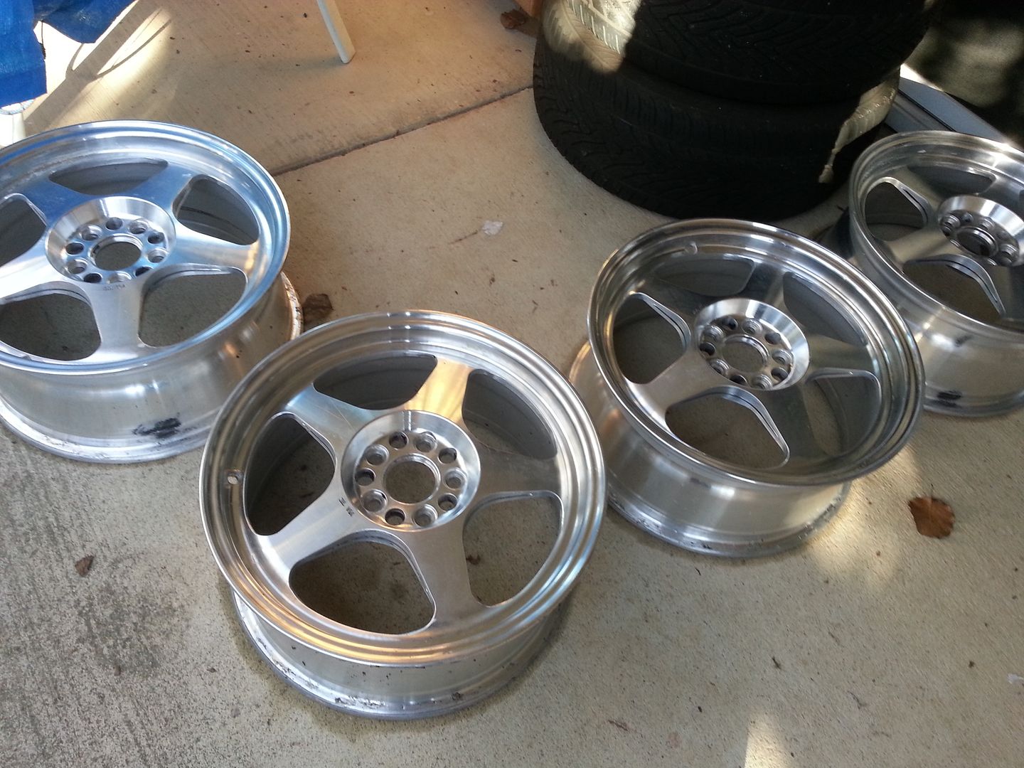

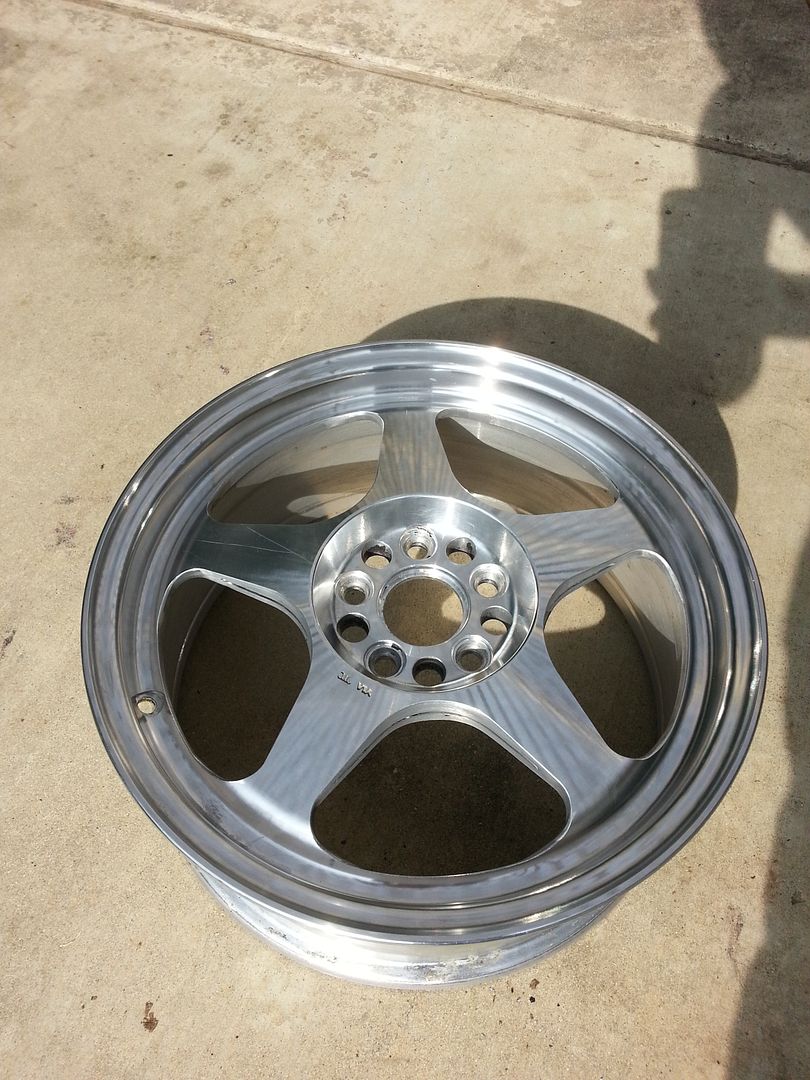

At any rate, after a few coats today, learned a few more things... My method was to POUR it directly onto the wheel and move it around so it stays thick. And as it starts to peel off, brush it again and brush the paint thats coming off so it gets the next layer. This was probably the most efficient, yet VERY messy, way I got it to work, and the results were damn good:
TEN YEAR OLD WHEELS THAT LOOK NEW! YAY!
I'm going to use some artisan polish to clean up some scratches and stuff, but I won't be doing a "chrome" like polish, not really into that look and these are beater wheels. But I'm very happy with what I learned from this and how much I saved (spent $60, but thats cause I bought the first can at $20... I could have done this for $40 if I bought the right stuff first).

Next time cover them with plastic wrap/trash bag. The stuff doesn't work if the fumes escape. Roughing them up with a bit of sandpaper will also give the stripper and easier time breaking the surface.

I've used this stuff many times in other applications (Bicycle frames) and I always sanded first, then dumped the stripper on, hit it with a scouring pad then steel wool and it always worked pretty well.

After a mild polish:
