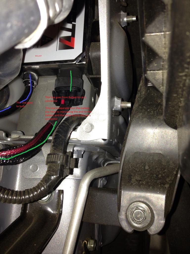

This is the ballast, there are only 2 lines coming out of the ballast. one goes to the bulb with 2 small connector(blue line), the other is jut a female connector where you have to insert the male adapter into it(the green line)

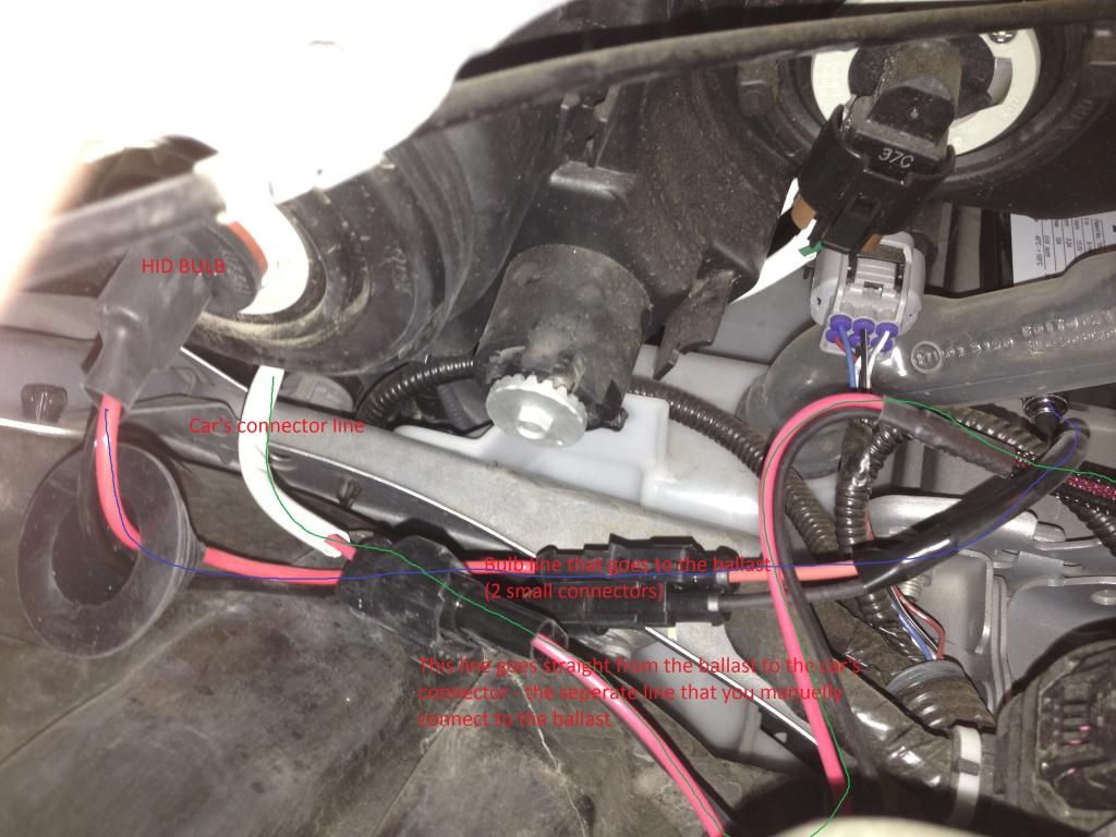

here is the bulb and the car's connector line, as you can see, the green line just goes straight from the ballast to the car's connector line via a male to male adapter that comes with the kit. and the blue line connects the ballast to the bulb.
again, you do not need to use the pre-setup relay nor the 2 capacitors that came with the kit but is packed outside of the opt7 HID box
Dude youre my hero nobody told me that i can just connect them directly like power > ballast > bulb on both sides lol im still looking for a nice place to stick the ballast though..
