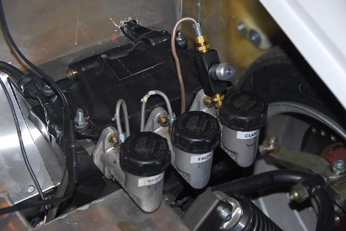

I installed a needle valve on my Minibusa so I could floor the gas peddle, side step the clutch, and it wold take a half a second to bleed down giving me a nice smooth launch. But this would also effect every gear change which may not work for you. I have a sequential gear box with full paddle shift on the Minibusa so once I got rolling I no longer used the clutch.

Thanks! My old BMW 135i had one of those valves.
I'm wondering if there's an adjustable needle valve or something I can install that would let me adjust the speed of the actuation.
I don't want to sidestep the clutch, just set my launch control to a certain RPM, then be able to dump the clutch and get a smooth launch without breaking axles.
I'm at around 300whp/225torque with big tires (PSS 265's) and I'm spinning them in 1st and 2nd.
I know better axles is better, but I don't plan on drag racing that much, if I could install an adjustable valve and launch consistently, then I'd try that first.

That's exactly what I'm looking for.
Good point about it affecting every gear, I hadn't thought about that.
In my head, it might still work, because the settings would be just a little slower than of a full dump.
Where did you find the needle valve?
