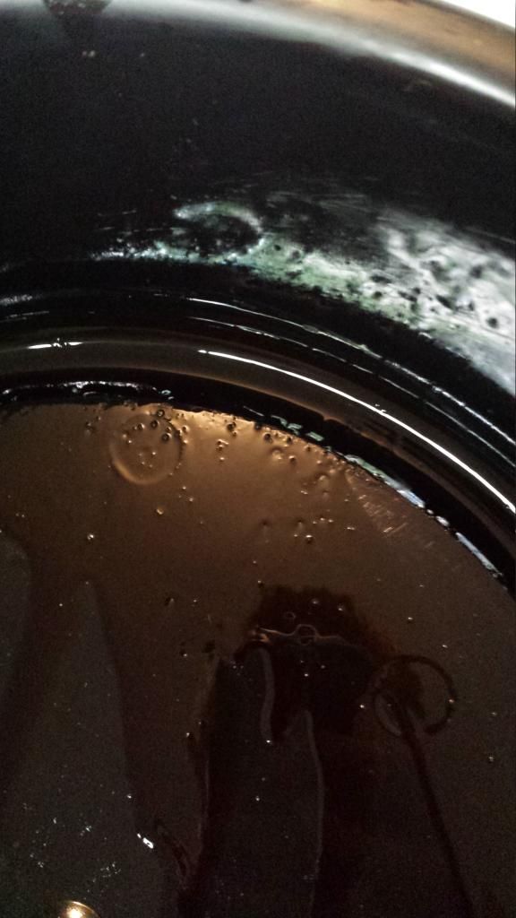

So last hight I noticed some grain of sand sized metal shavings in my oil after I changed it. Changed it after 6.5kkm, mobile 1 afe. Normal? Probably 10 or so grains of metal total. Pretty sure I heard my car knock once extremely loud last week. It's never happened before.

Save any of the oil for a analysis?

Take an oil sample and if you could use other car until find out were the particulate came from.
Any modifications? FI?
Check compression and pay attention to any different or new sound(noise).

I have the oil still. Transfered from my new plastic oil pan to the new oils 4.4l empty jug. Is it still good for analysis? I've never sent an oil sample out before. The engine sounds and runs fine.

However, if the sizes are as large as you state, I'm not sure an oil analysis will do much. They read parts in PPM, large parts are brushed aside for this testing. Post up some photos, that may be able to help us narrow down where the metal came from.

Btw, is this your first oil change? Metal shavings are common during the break-in period.

I have 32,000km on the engine but this was the first change I did myself. I didn't clean out the oil pan with the shavings still in it. I'll post pics when I get home from work.

was your oil pan clean before you drained it? you didn't "rinse" anythign off the bottom of your pan and into the container did you?
