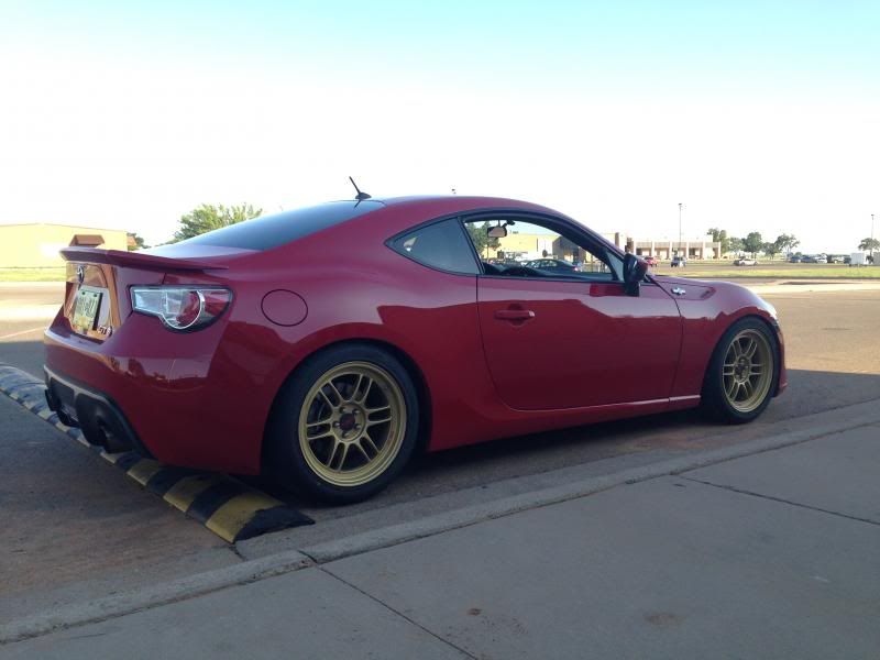

I have them in 255/40's on 17x9 RPF1's. They run really wide, and while they are fun to slide in and look meaty as hell, I can't help but think after they were broken in they feel less grippy than my old 235/45 nexen n7000's. Maybe I should have gone with a 35 side wall..
