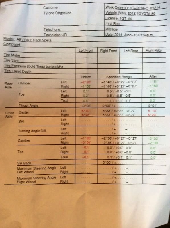

I've got my rear camber -3.3 and toe in 8 mm with longest position of SPC LCAs after direct swap from stock rear LCAs.
Attachment 82746
Adjusting both eccentric bolts of stock toe arms and SPC lower arms, finally got camber -2.0 and toe 0.
20 mm down by RCE Tarmac springs.
So I can say that at least using SPC LCAs another toe arms are not necessary for usual applications.
