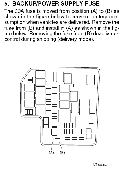

I think I found it, I will update you guys soon
Attachment 80474
That's it. I'd be wary of going to a dealer that told you to "go ahead, keep driving, it'll go out" that's complete utter bullshit.
Btw, I've PDI quite a few BRZs, never had I disconnect the D-check connector. It's not under the kick panel like the PDI sheet suggest. I don't think it has one, at least the BRZs don't.

If fuse is in the correct location, take to dealer (or another dealer) and make them fix it. End of worries. Can't believe you have driven it a month with the light flashing and believed the dealers BS about it'll go out?
