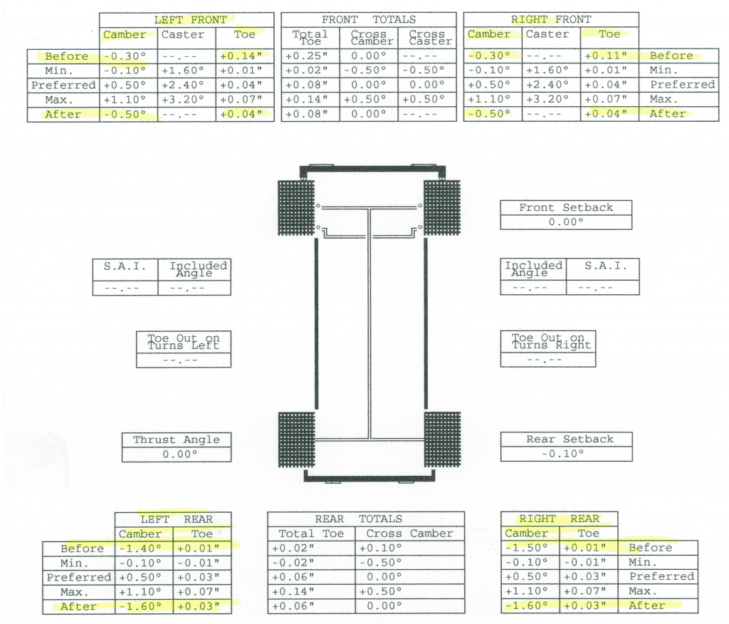

I recently had an alignment done which was supposed to fix some of the issues I was having but now I have more problems....
When I get on the throttle the car wants to pull to the left, I mean changing lanes pull to the left. The car feels like its also dragging abit and I have to use a tad more throttle to keep it at a constant rate of speed.

Do you have the results of your alignment?

^^ This, without knowing the outcome of the alignment it's just wild guesses in the dark.

This was the alignment I got before I fixed the problem with the anti dive kit. The front drivers side is where the issue was.
