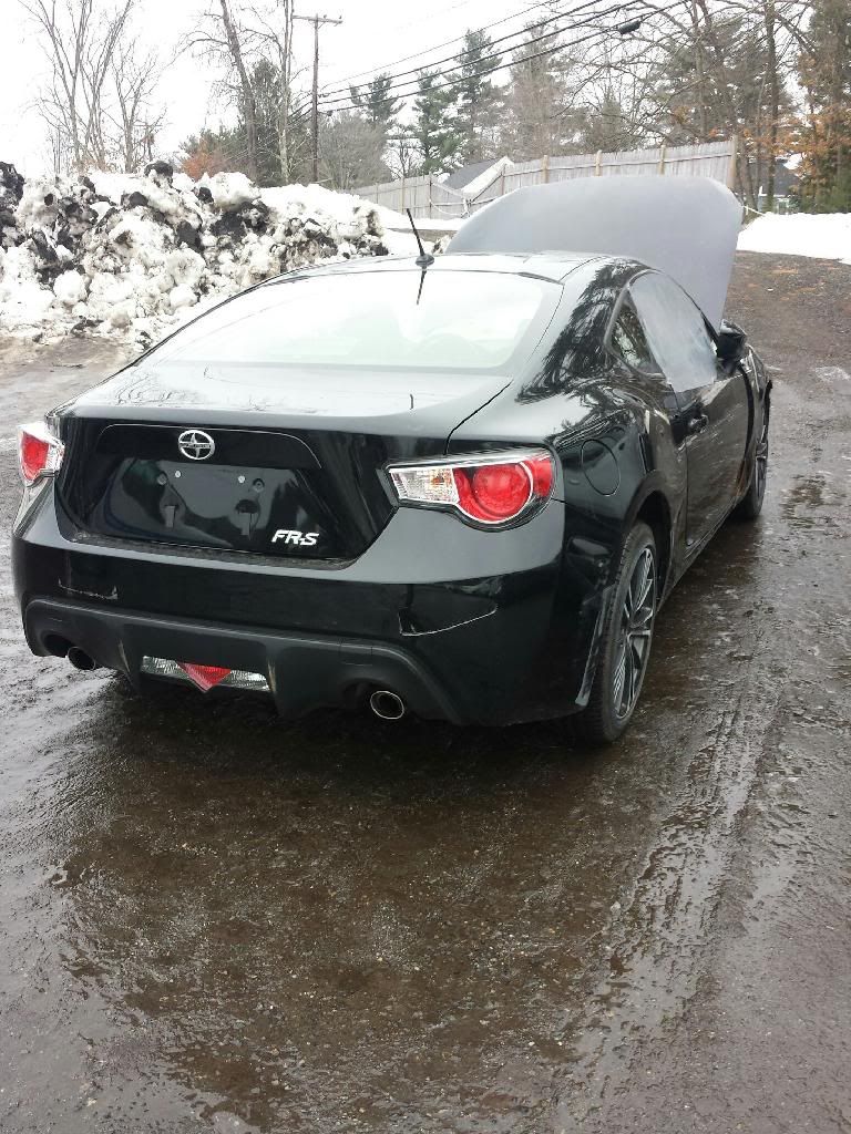

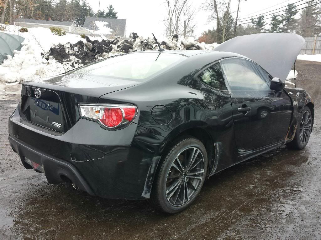

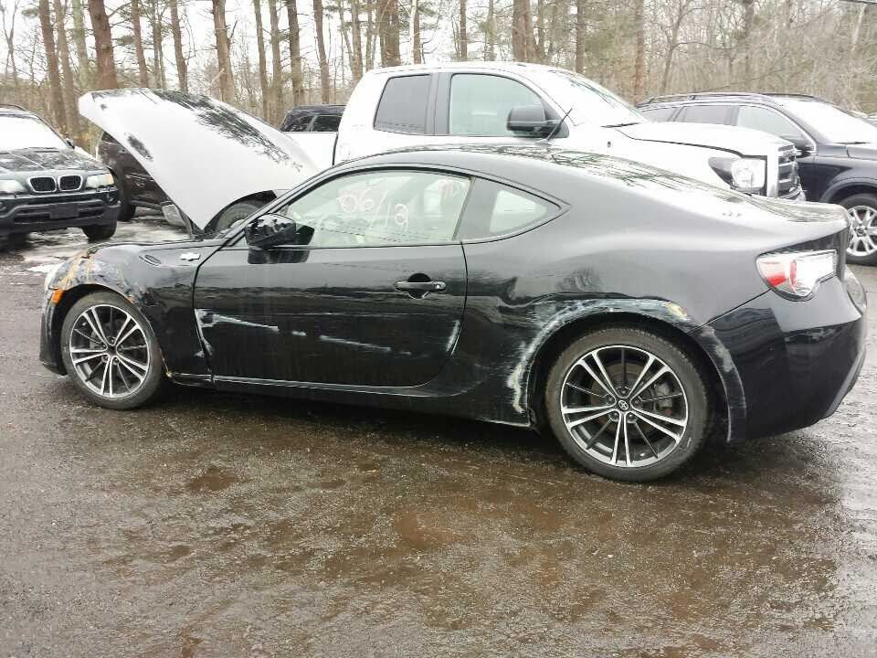

A little background, I got laid off and sold my 911 for a damaged 2013 FR-S to repair and drive as i wont have a job, time was not much of a factor.
I got into Her a bit and found No real structural damage that cannot be replaced by bolt on parts or minor welding.
Things are straight except the fender and headlight mount.
Once into the repairs I wanted to see about a turbo kit because while i had it apart, i figured it would be the best chance. I didn't want to get a top mount and i don't want the AVO kit because of the external Oil pump.
I called the custom-shop guy i traded the car for originally and We are currently working on a turbo kit! Ill post pics of that as they come along!
Anyway, I just wanted to start showing my progress as things go!

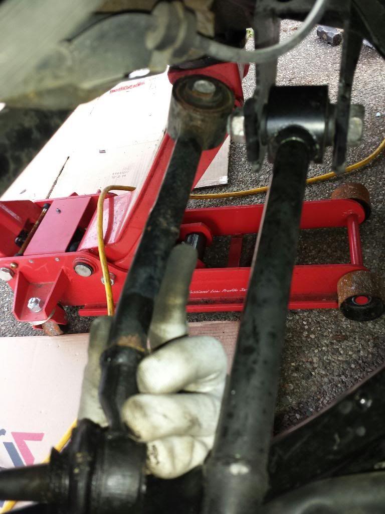

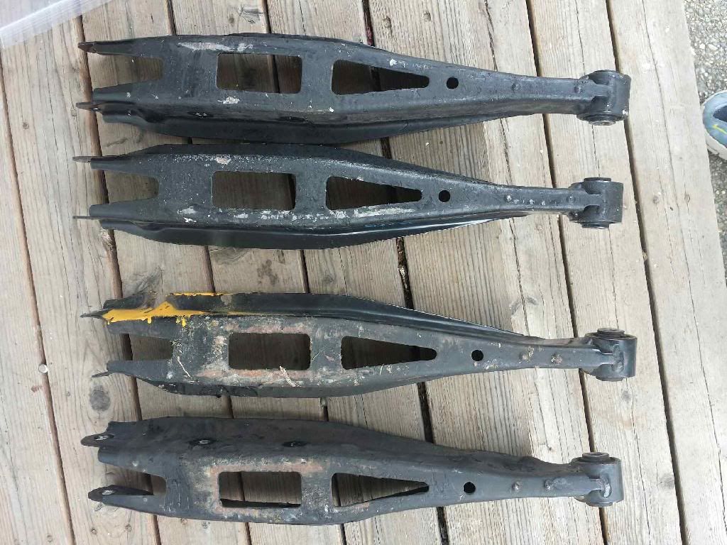

The positive camber in the rear would be something Id look into...

Fett4Real - Totally right on that, replaced both Lower Control Arms and the Pass. Side Toe Arm. Have to do some adjustments but its looking much better now.
Because i now had a set of bad LCA's, I had an idea to do some drop knuckles like the old 240's and even fiero's!
This should give a coil-over look (geometry will change a bit) but keep the factory struts longevity and feeling.
Ill post that separately to keep flow.

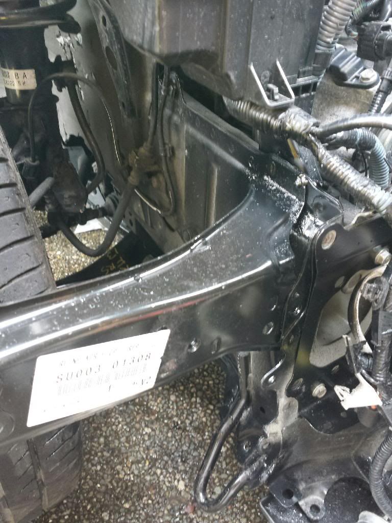

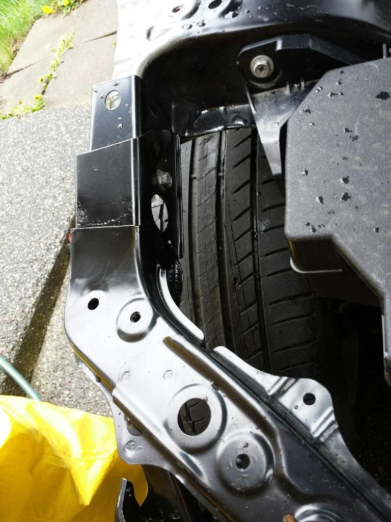

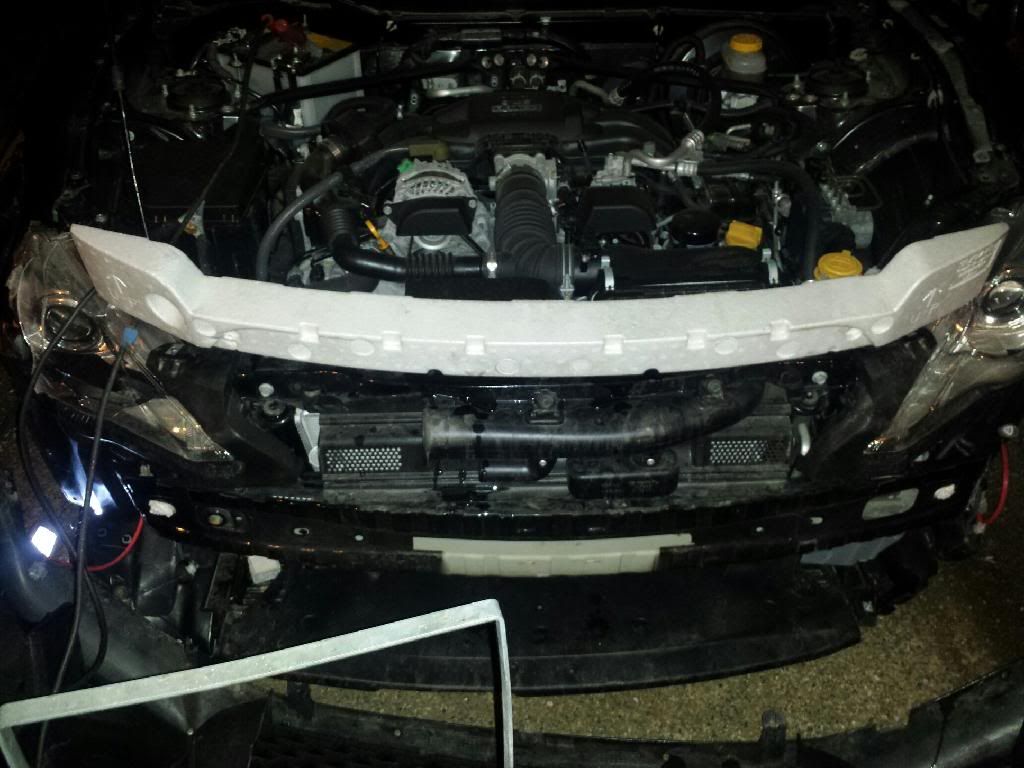

Is the fender frame bent? Is this going to affect how the car handles at all?

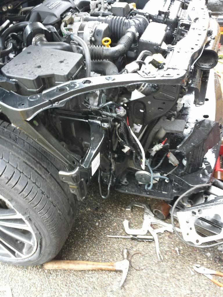

I worked as a Manufacturing Tech Engineer at my previous job, This stuff is just so fun to do!!
HunterGreene - The damage stopped at the fender rail, Toyota and Subaru did some amazing engineering on this car.
We racked the car with infared at every point and shes OK on that.
The damage was is layers, heres some pics.
Damage with the New support on the ground.
Removed the support, Drilled out the port welds.
New Support welded into place
all nice and new!!!
