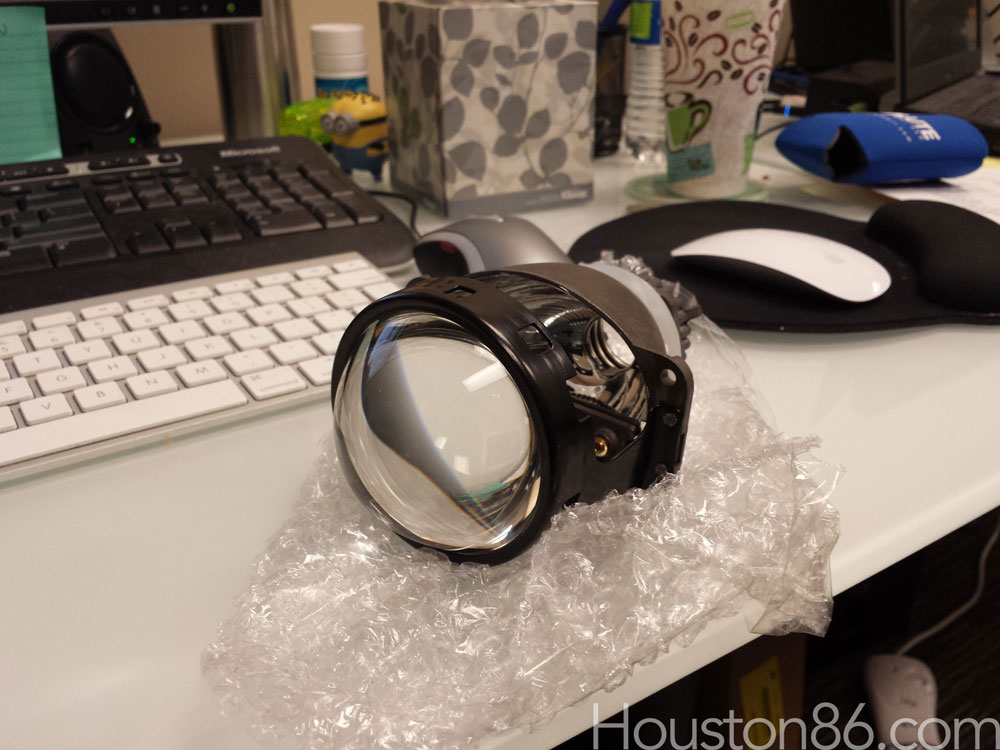

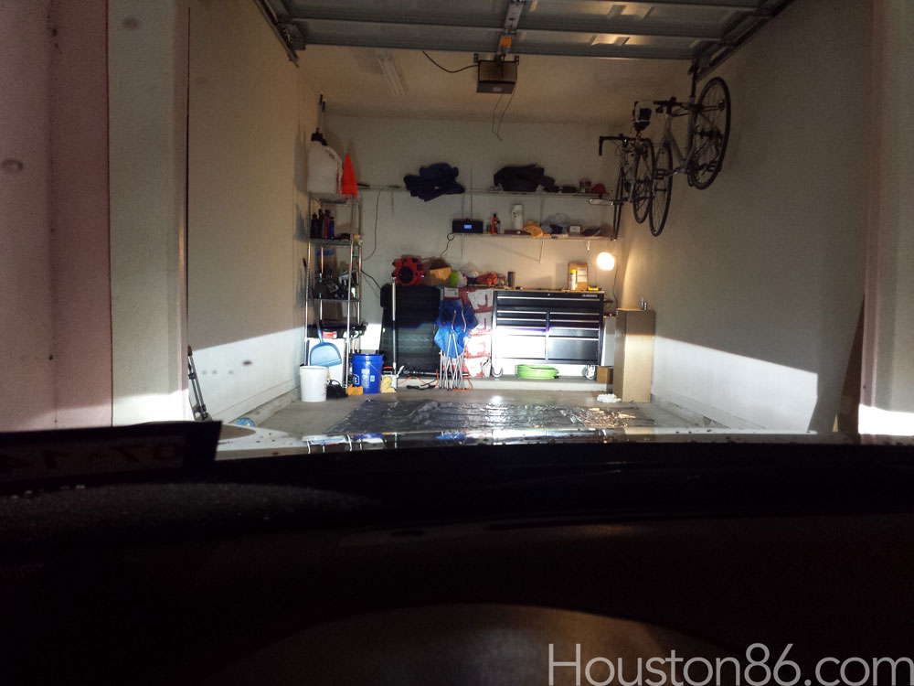

DIY Retrofit Winjet headlights
Everyone loves the Winjet headlights, JDM/10 series headlights for under $500. Well the only problem with them is the light output isn't the best. The cutoff is also kinda crappy when using HIDs. So lets fix that.
What you need:
D2S projectors from morimoto
D2S HID bulbs
HID relay harness if you haven't installed one
I purchased everything from http://www.illuminatinglightworx.com/
So the Winjets use a knock off of the D2S projector. They have a modified bulb connector to use H1 bulbs. Luckily you can very easily replace the projectors that come with the Winjets by purchasing the D2S round projectors from the retrofit source.
These projectors are plug and play. They screw right in, no adapters needed. So how do you get the headlights apart?
Set your oven to 200F and make sure it's stabile. Put the headlight in for 8-9 minutes and grab a screwdriver or panel pryer tool and get to work. You'll need to remove the screws from the headlight before you bake it.
Once you have the new projectors in repeat the process and put the screws back in while it's still hot.
So with that done button her back up and plug your D2S HID's in and you're good to go!
