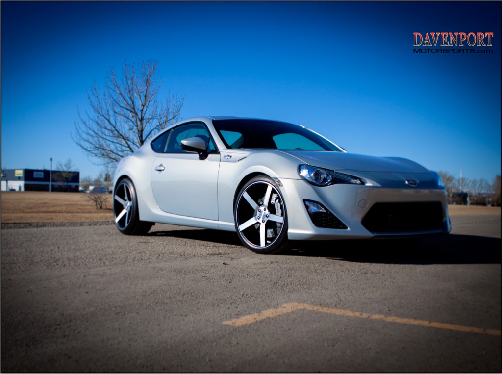

Here is my 10 on Vossen 19's before I changed the suspension.
And here is after

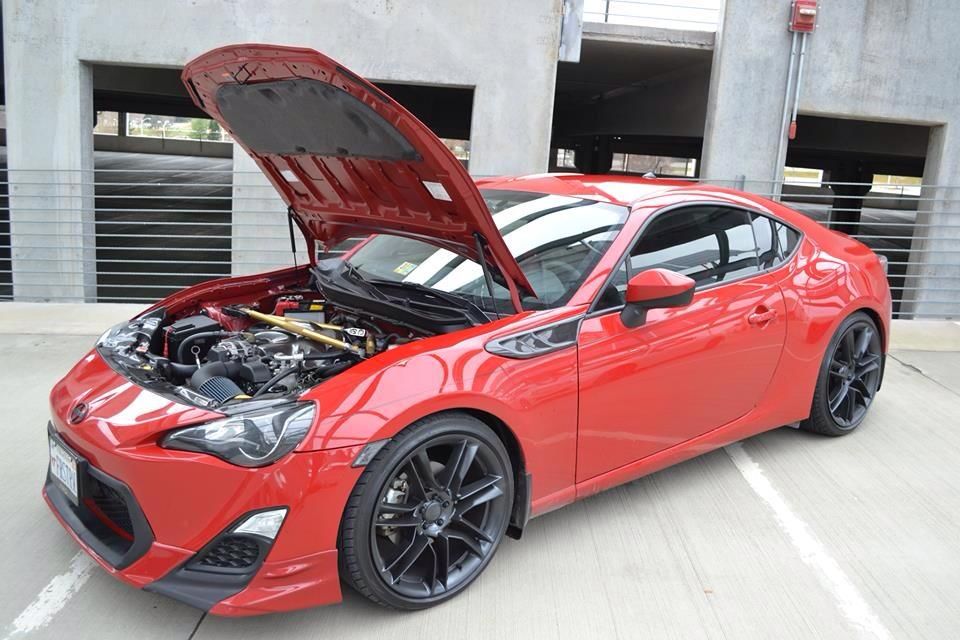

Size:  98.6 KBName:  ImageUploadedByTapatalk1395060320.271652.jpg
19x8.5 +45
Lowered on Eibach Pro Kit
FRSTRM is offline   Reply With Quote
