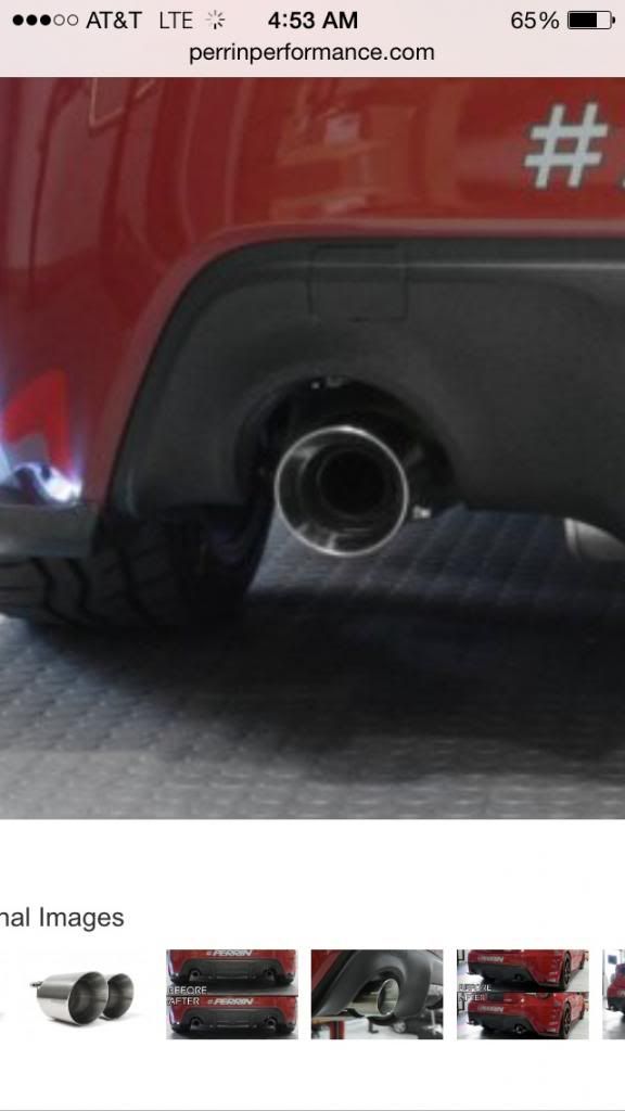

Hey guys i was wondering if its possible to cut or remove stock exhaust tips and have the Perrin 4inch tips welded on instead of the clamp install option?? just dont want all the noise and attention aftermarket exhaust bring...

I have the Perrin tips and you can weld them if you want

Why weld them? If you ever decide to get an actual exhaust you can remove the Perrin tips still and sell them for like $140-$150ish. Doubt anyone would want your stock exhaust with the tips welded.

One bolt and the old exhaust tips pull off. One clamp and your new perrin tips go on. Done

Just wondering cause I've seen them installed and they have that screw sticking out the side.. Kinda looks ugly no?
