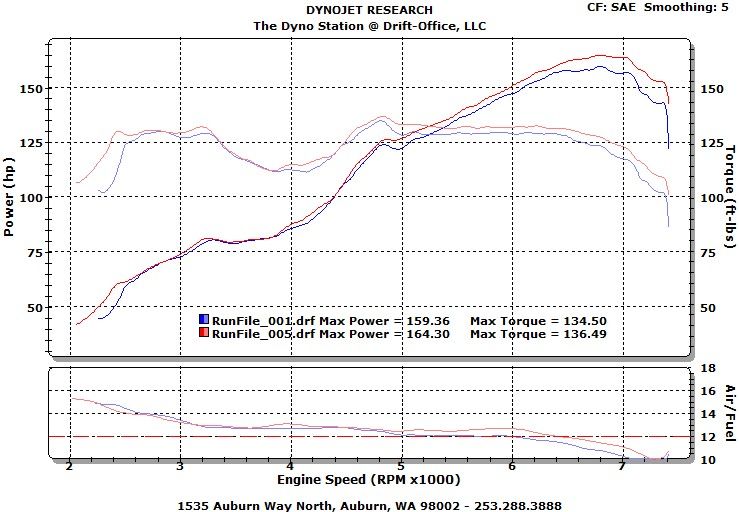

hmmm thats weird, let me dig around and look for my baseline dyno. i know mine was higher than 140
heres my baseline, Blue is stock and red was after injen intake install both are on OEM ECU tune

For some reason the Dyno numbers here always read lower than what you guys get over there. Must be the heat or humidity we have here.

hmmm i think so as well. didnt realize you were from Philippines, but i know from experience you guys get 100oct there easy so the numbers should be better.
