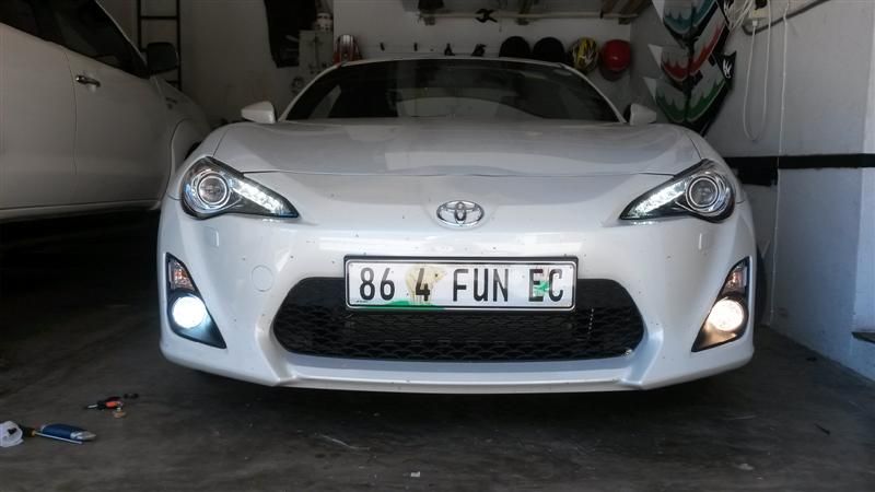

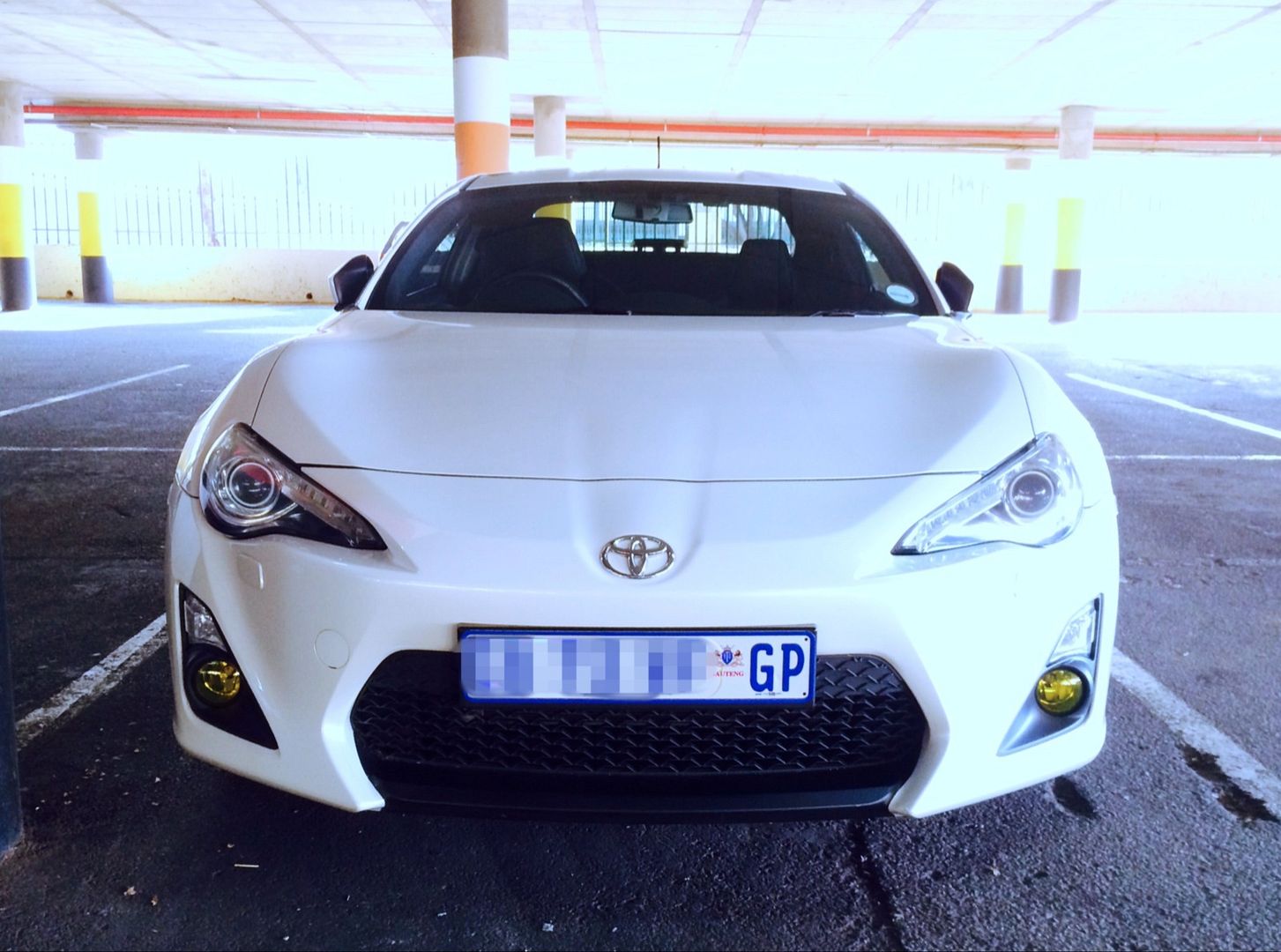

I installed my Chinese LED's. Anyone spot the difference? I'm very happy to get rid of the candlelight look.

Looking good!

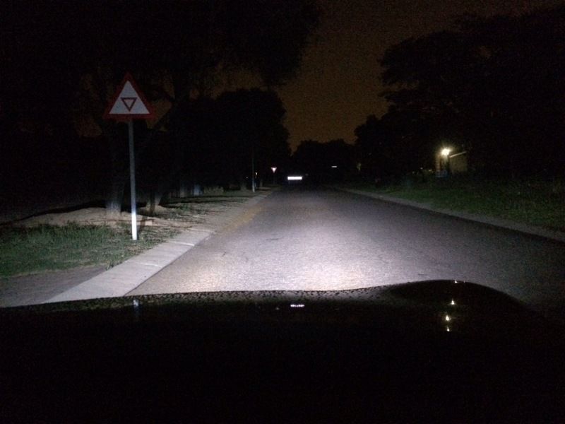

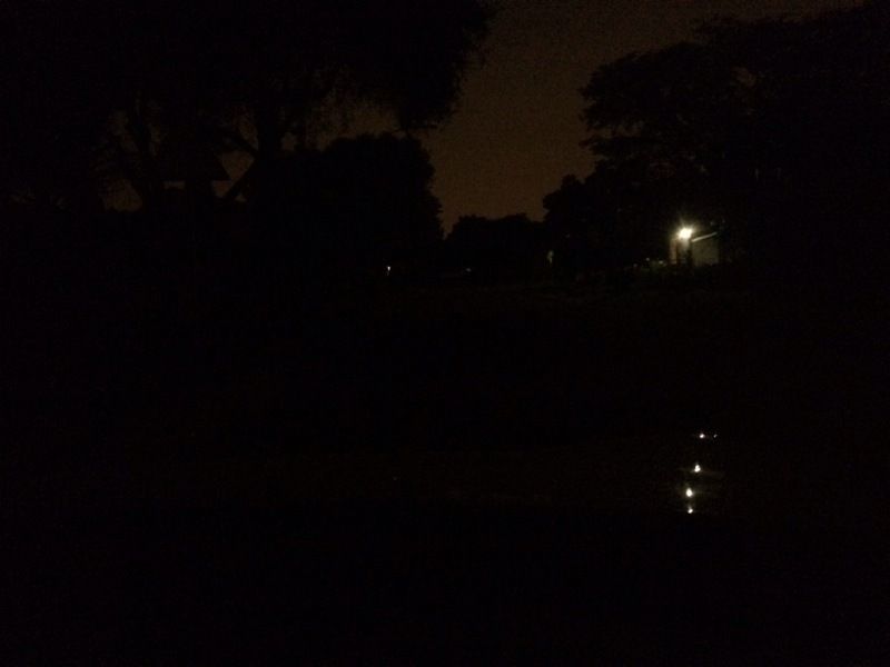

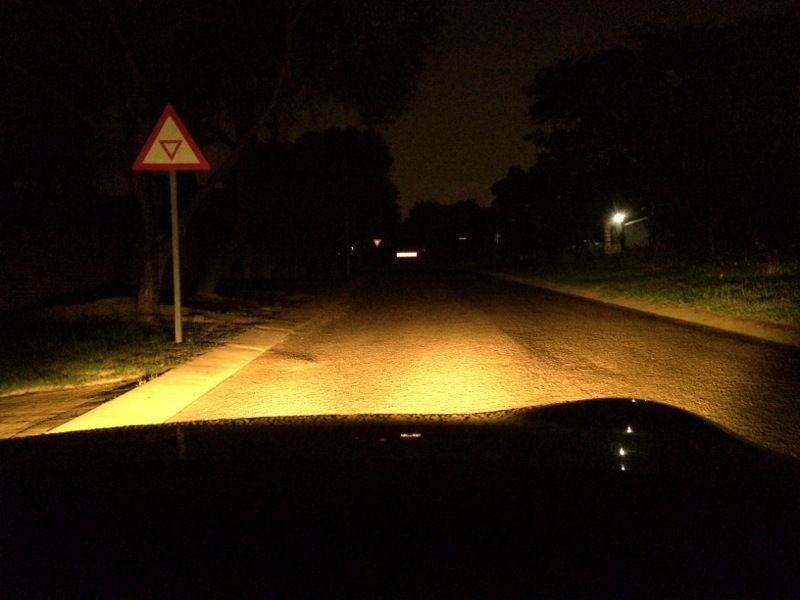

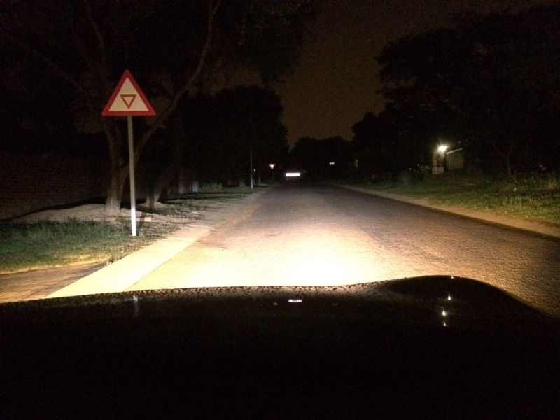

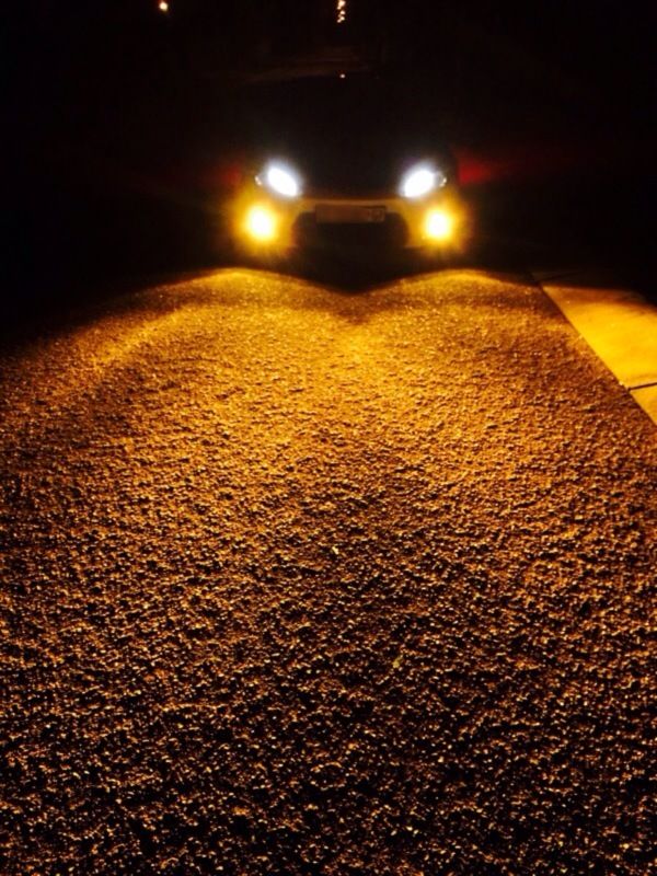

I've gone the exact opposite way. I don't drive with fogs on unless there is fog or very heavy rain, so when I do use them I want them to work. Unfortunately our cars are fitted with useless 24W H16 globes so I've upgraded the fog lights with glass casings and proper 55w H11 globes.
Off:
Fogs only:
Headlights only:
Fogs & headlights:
Fogs & DRL only:
Probably not to everybody's taste but I like the retro look:
I actually still need to adjust/aim them properly but haven't had a chance yet.
