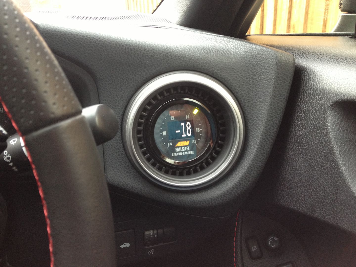

What pods is everyone using? Stupid question but does the failsafe read both boost and A/F at the same time?
Admired is offline   Reply With Quote

Mentioned: 45 Post(s)
I went with a pod that replaces my defroster vent on the drivers side.
looks like this:
It can read both boost and AF a the same time. Either PSI on the OLED in the middle and AF on the outer-rings LEDs, or vice versa.
xjohnx is offline   Reply With Quote

Mine is mounted in my side vent:
Pitman is offline   Reply With Quote
