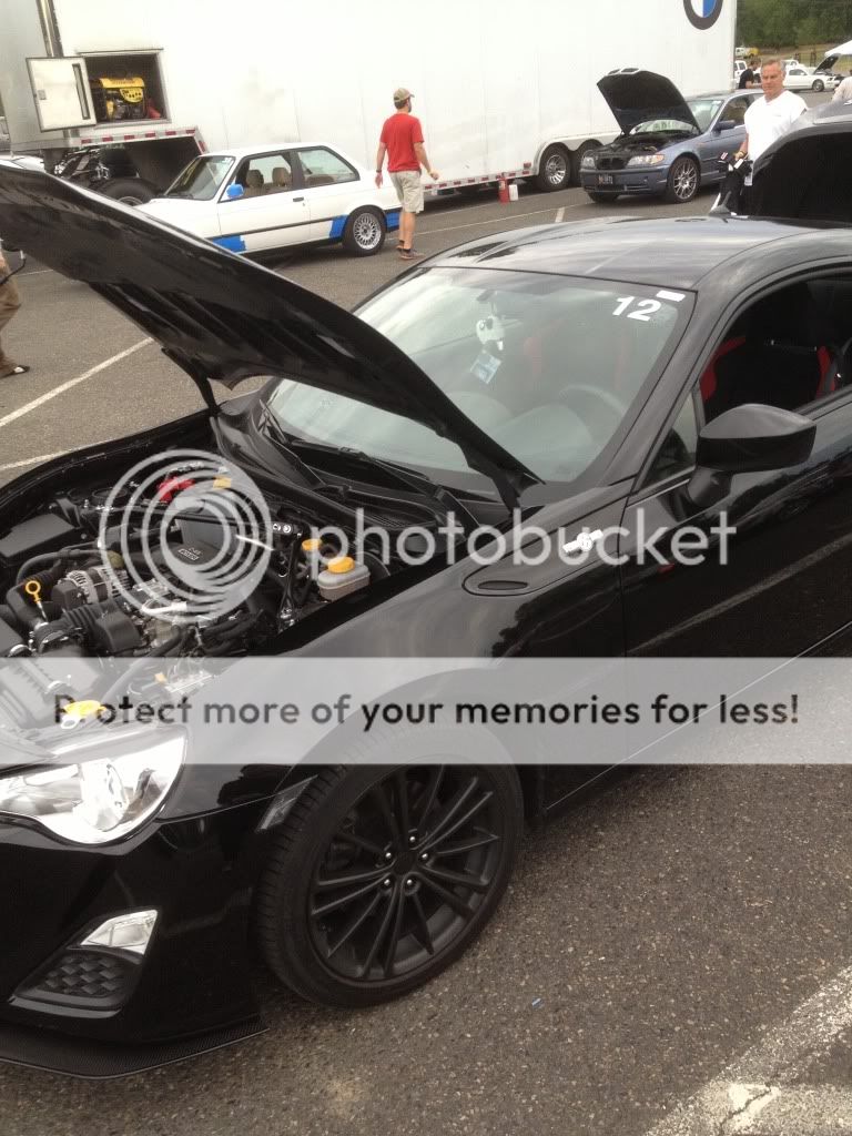

Not true. Used 2 cans for all 4 wheels and had some left over. 4 coats each and ur done.
