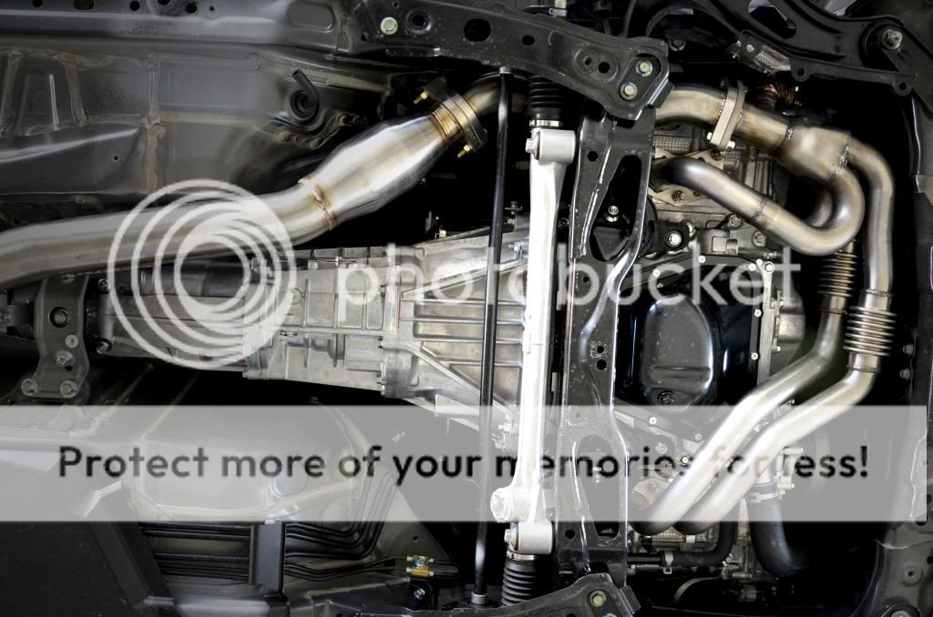

So about a month ago I installed the Perrin "Big" 3" Catback exhaust on my car. Fit, quality and sound were all awesome, and actually better than expected.
When going to order my Perrin 3" Front Pipe and Perrin Overpipe, I was lured into the purchase of the Borla UEL Headers, by what I thought was a good deal at $569.95 SHIPPED.
So I pulled the trigger. Thanks to Jordan at Defined Performance I received all parts within two business days of placing my order.

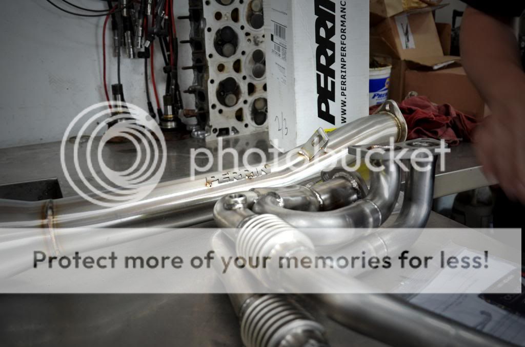

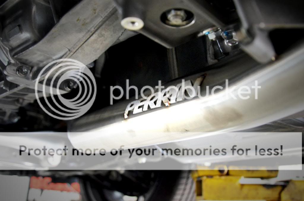

The quality on the new Perrin 3" Front Pipe and Perrin Overpipe appears excellent and they certainly fit perfectly. I continue to be impressed with their quality of workmanship.

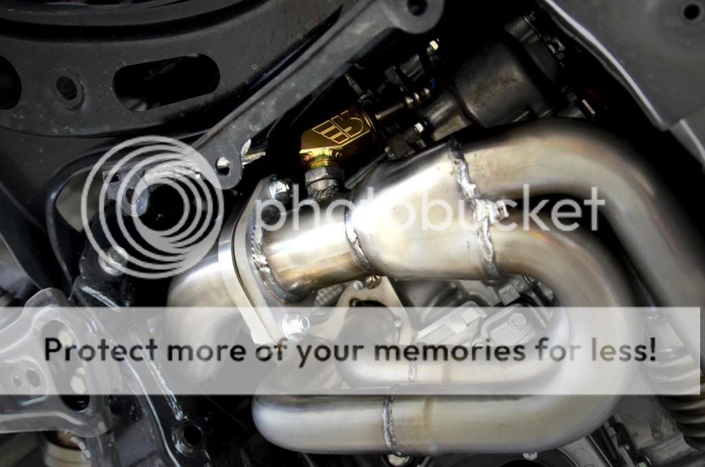

The Borla Headers FIT perfectly, with no installation issues, however from a aesthetic standpoint, I was less than impressed with appearance and quality of the welds. That being said it went in more quickly than I had even anticipated, without a single hiccup.

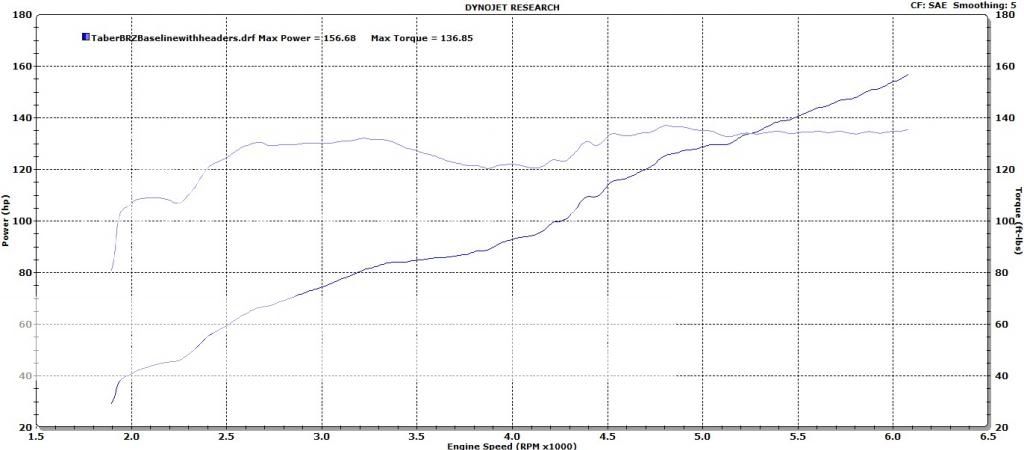

Install time for me on all three pieces, INCLUDING setting the car up on the dyno, running it 3 times and taking it off was 2hrs 15minutes. Not bad, considering the headers on my E46 M3 took me 8hrs to install...
Please keep in mind that this car does not have software yet. Calling FA20Club and ordering ECUTek and their N/A software is next on my list of purchases. I did install an O2 Sensor Spacer under the rear sensor, although I doubt it will be adequate for keeping my CEL off, we'll see.
The car FEELS noticeably better to me after install, and from a performance perspective I am pleased that I decided to do the headers in addition to the front pipe and overpipe. I am new to Subaru's and am not yet sure how I feel about the sound created by the UEL headers, I'll see if it grows on me.
Installed Pics, Dyno Video and Dyno Plot (It was quite warm and INCREDIBLY humid when I dyno'd this morning.)
Only ran it to 6200, as the ecu didnt have any time to adapt, and I didnt load software, I didnt see the point in flogging it. I will do full redline pulls before and after software.

That TQ dip is already gone without the tune..nice! You will love the FA20Club tune with this setup!! My setup is similar but I have 2.5" catback. Super easy install on the header for sure!
Nice work!

Thanks Chad! The Torque Dip elimination/reduction is extremely noticeable on the street. My car still only as 1,300 miles on it and with this set of modifications its really much more of what I had originally expected the car to be like from a power delivery standpoint, when stock. Cant wait to get software.

Very nice numbers, you wouldve probably easily hit 175-180whp.. you're just teasing us.

What brand is the o2 sensor spacer look nice

but if you have a before and after dyno, that would be perfect because there is a debate going on that 3" set up would lose power and all.
do you think there is a power lost overall?

Its the Rennen Performance Spacer (www.rennenparts.com) They're a VW/Audi Performance shop.
