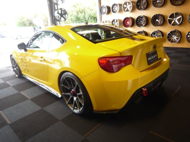

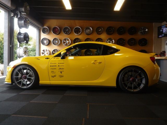

I know where and who fabricates them ill post some pictures in a bit
