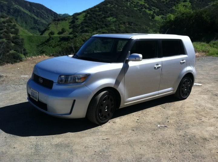

I have been a long time reader and have always been holding out on buying as im deploying in September and did not want to leave a new car sitting for 8 months, but then i gave in. Did not wake up expecting to buy a car today, but after work I saw the dealer down the road had an asphalt one in manual and a few hours later I went from this to this:
I will miss the sex box, box nasty, ice cube, toaster, what ever you want to call it
