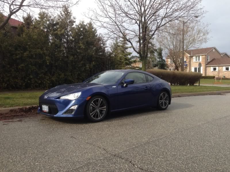

Another popular spring is Eibach Sportlines, that's what I went with. Gave the car a nice drop without being too low (wish I was lower honestly). My rear camber was around -2 on both sides, I added lower control arms.
The stock ride on these cars is already pretty rough, springs didn't help, it's rougher, but I'm also on bigger rims with less tall tires. With the new tires and springs the car just grips, turns like it's on rails. A lot of the playfulness from the stock tires is gone, but the car can still be rotated, I actually spun it at the last auto cross event I attended.
Don't have many pics on stock rims, sorry about the shitty quality.
