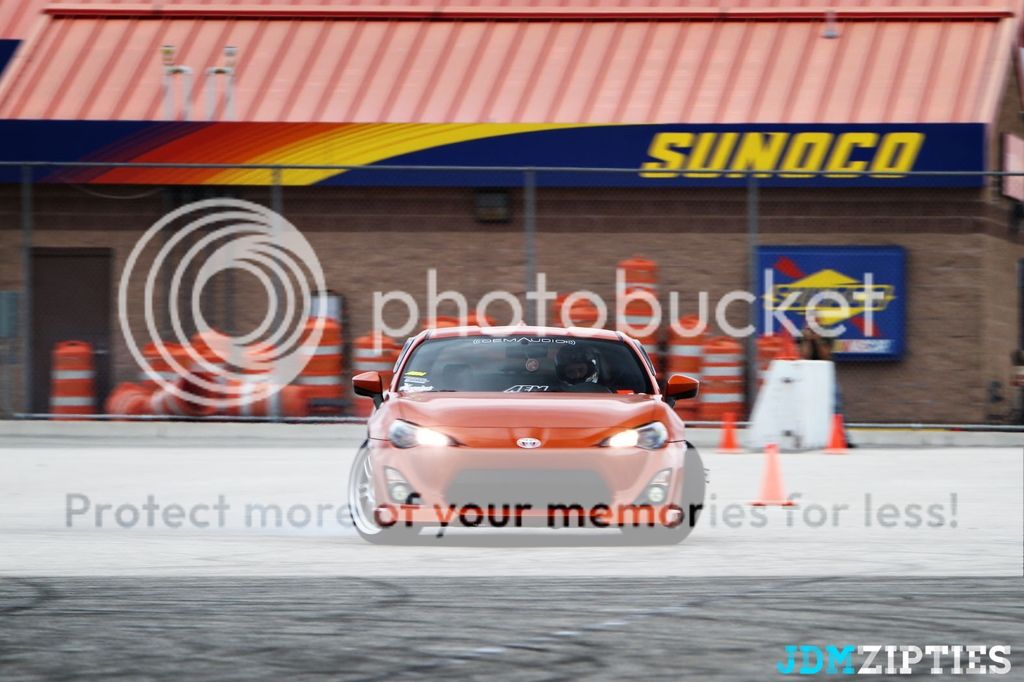

Here's mine drift setup that day...
[IMG]http://i373.photobucket.com/albums/oo179/96jdmls/ED7A5977-DA51-45A2-80D0-62B92294C1D7-2486-000001253B09B32C_zps60c***27.jpg[/IMG]

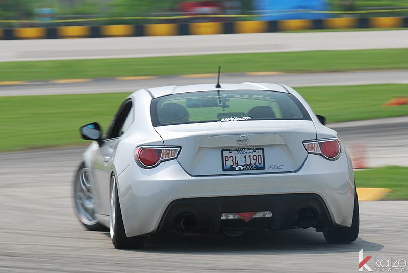

run 9.5j +25 for daily and street drift and have a pair of 9.5j +40 i use as spares at the track. 225/40 on all wheels. run bc coilovers and stance lca.
