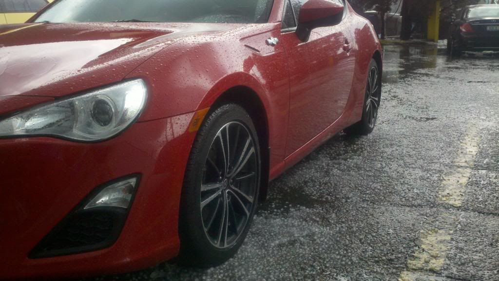

Well, just in case anyone has asked the question "How do our cars stand up to hail?"
Well, I have an answer--depends on the part of the car. We had dime-nickle size hail up here in Cleveland on Friday last week (5/10), and initially the car looked fine. I couldn't see any damage.

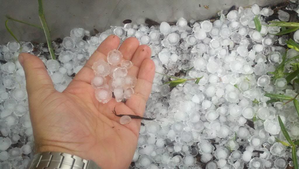

Hail was this size:

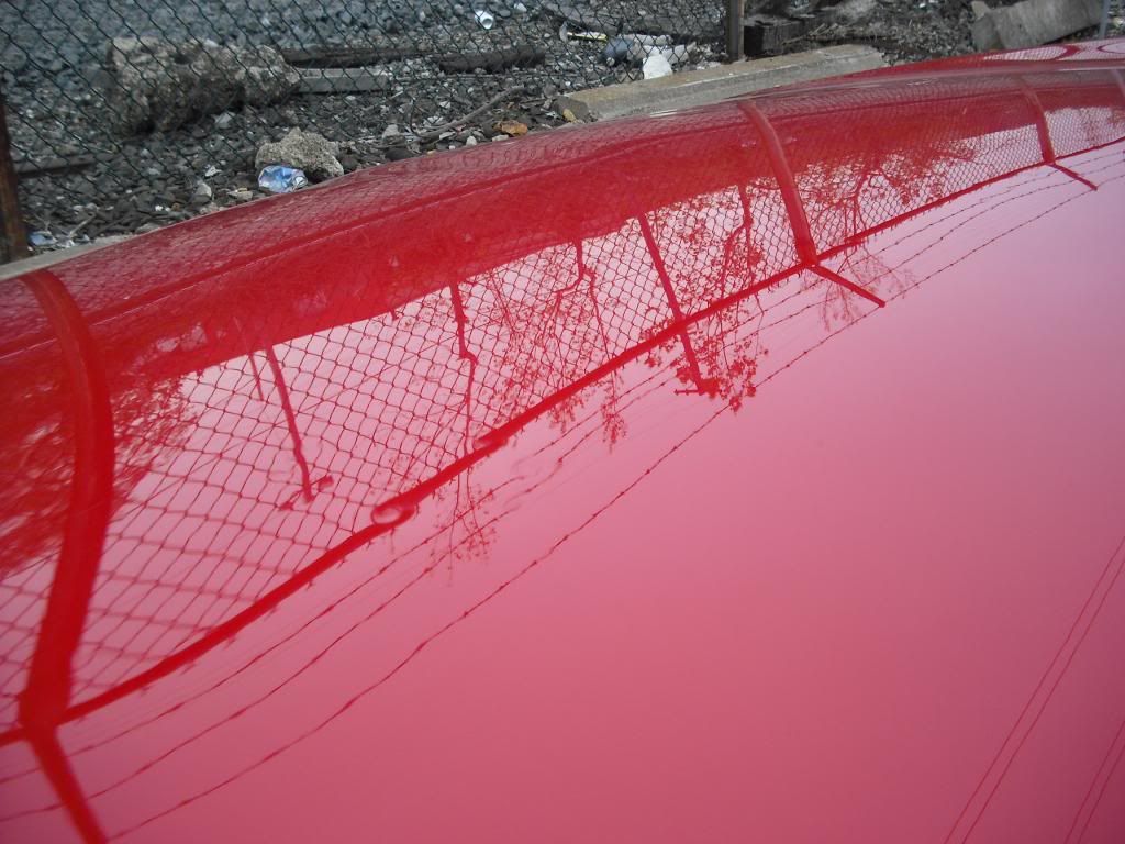

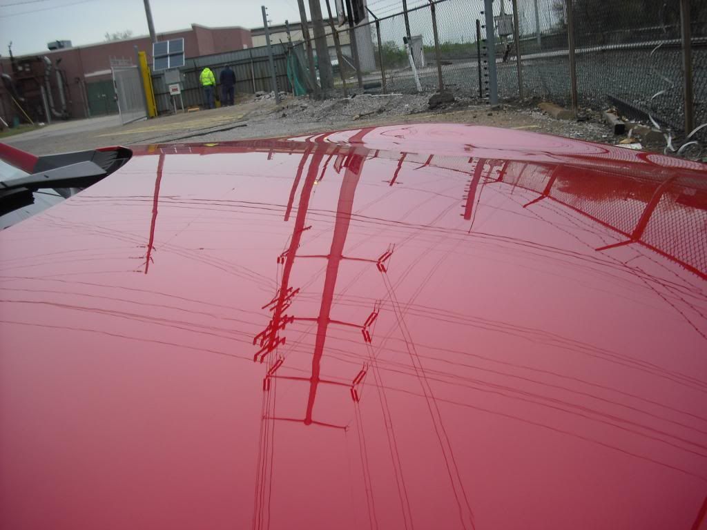

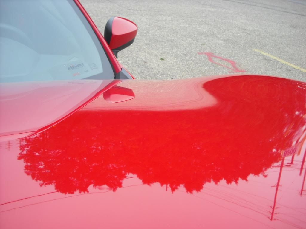

Fast forward through this past weekend to last night when I am coming home from work, I get out of the car, happy to be home, and I see pockmarks. I got some photos, sadly, they are hard to pick out in the photos. You can see some distortions in the reflections that are definitely not the orange peel, if you look closely. They're all over the hood.
