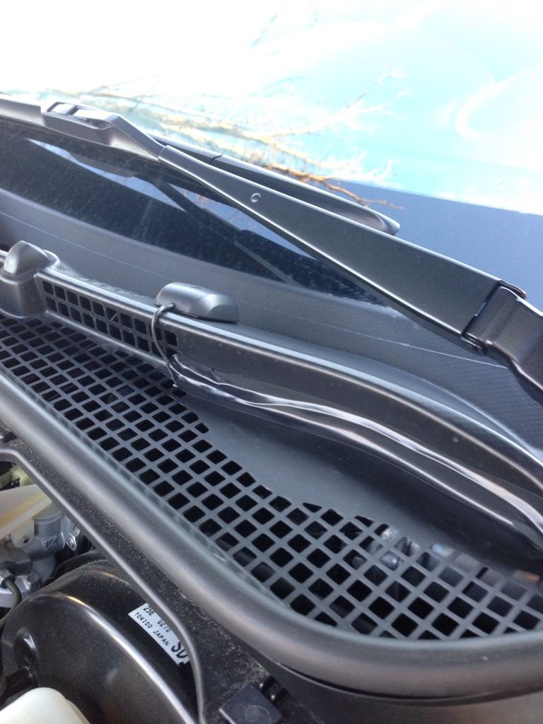

Installed a pioneer avh-x5500bhs the other day and got the siriusxm adapter for it. Tried to put antenna under beat sonic shark fin and it would not fit properly. I decided to mount it here.
[IMG]http://i1261.photobucket.com/albums/ii600/mbh1101/8d2***4a-1a73-4dd7-8ce6-f3f0ebcc4a1f_zps5e639c80.jpg[/IMG]
On day 3 of having it and so far my signal strength is doing great.

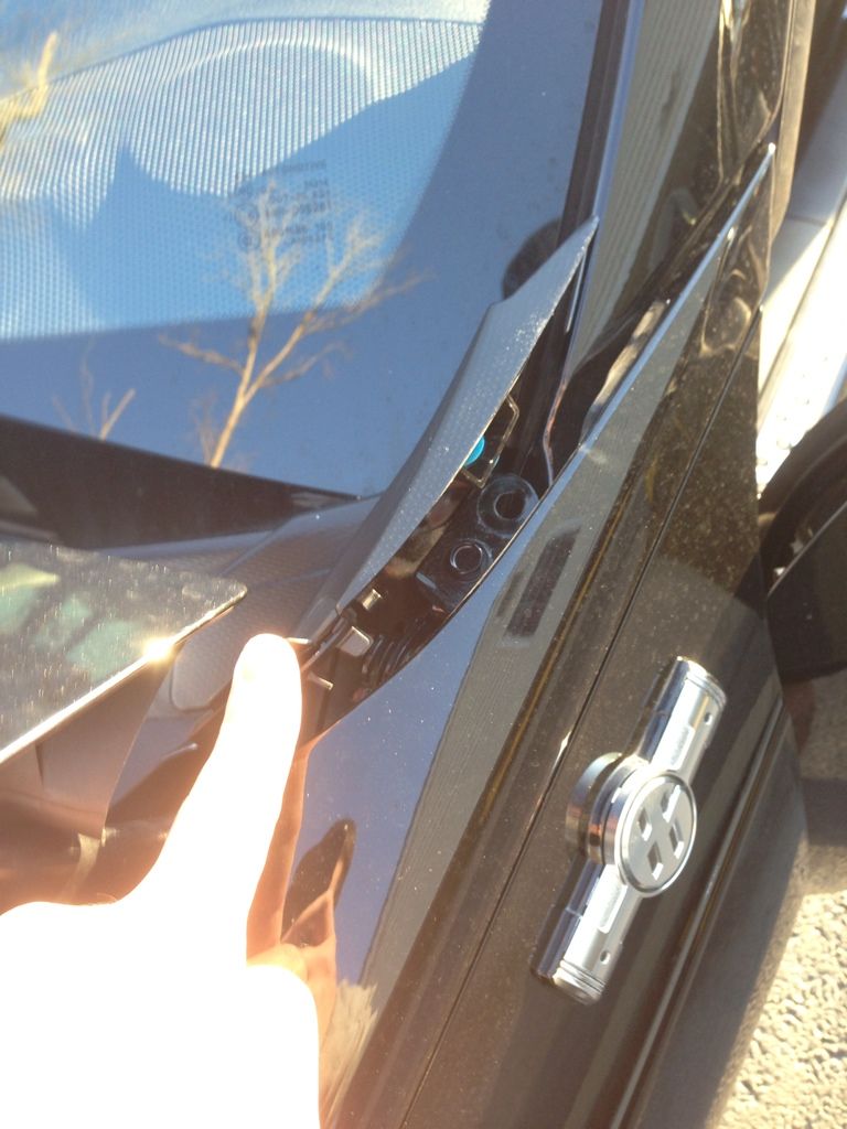

The plastic piece near the windshield pops off very easy.
Just used some electrical tape the hide the wire and its that easy. Took me maybe 15 minutes tops.
