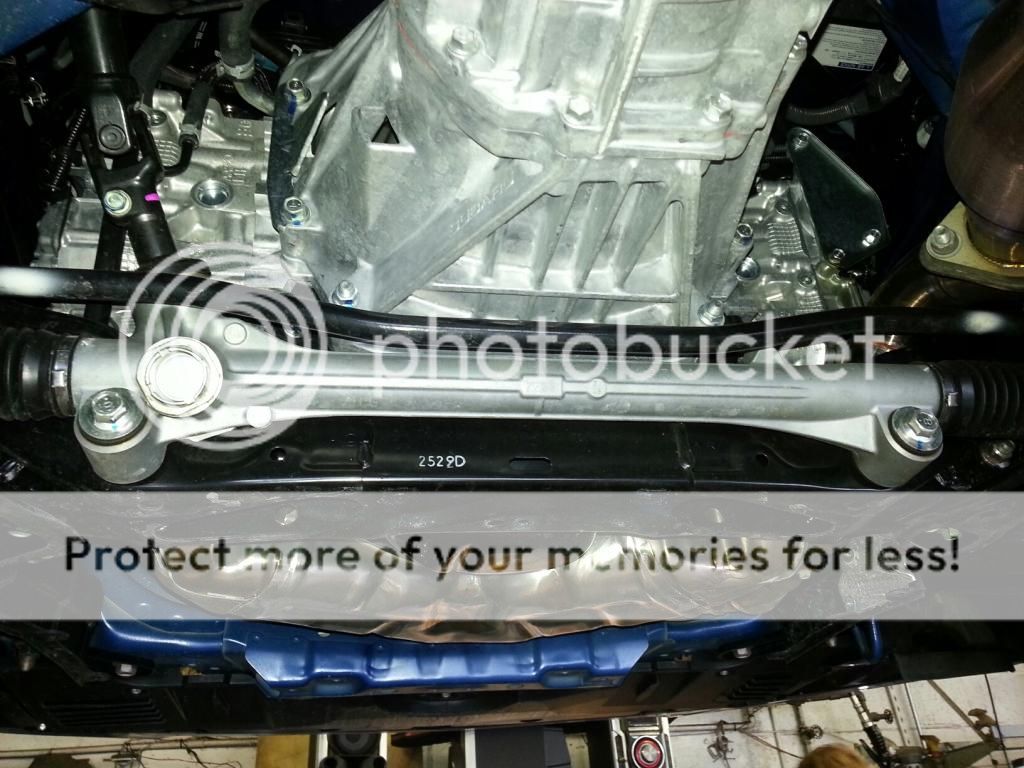

I installed the Whiteline 20mm front sway bar and end links.
Remove bottom covers

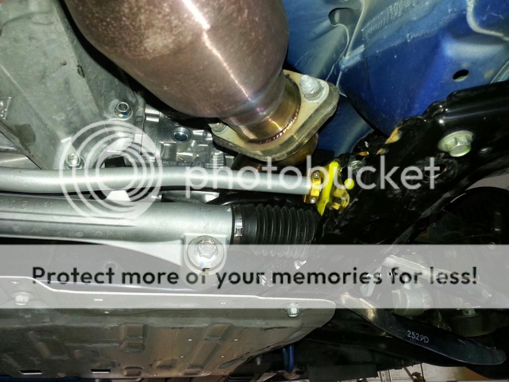

and a clip on the side

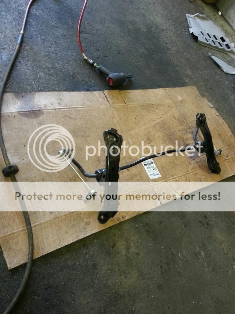

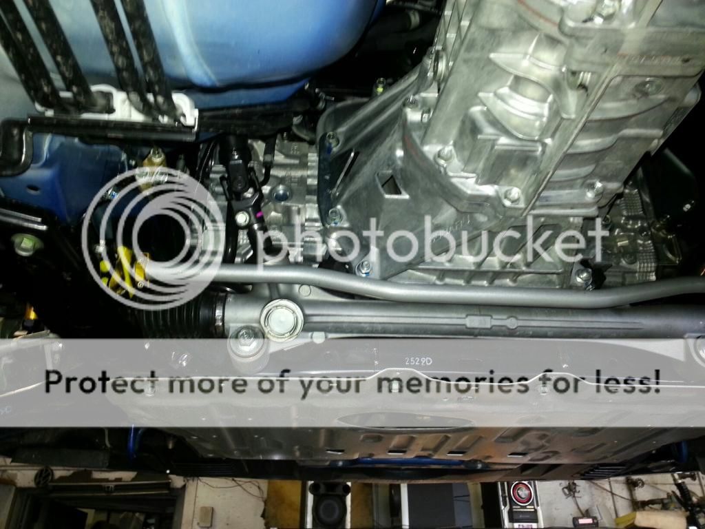

Then remove the two frame supports that hold the bar.

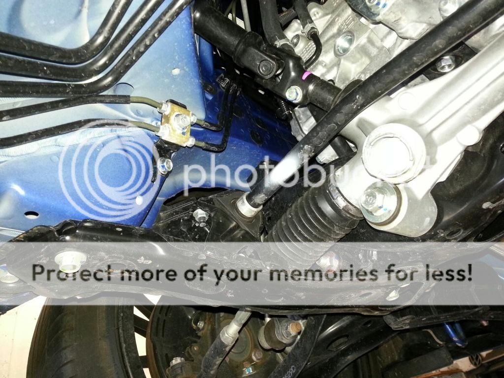

Remove the brackets that hold the bar on, instal them on the new bar bushings, remove the nuts holding the end links to the struts, and install evrything in reverse.
It weighs 1.8lbs more total then the stock parts.
