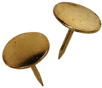

I was hoping it was because of the cold, it went from warm room temperature garage to freezing temp but when I checked the tires out, I found a thumb tax, like the ones u use to put on the foot of a furniture so it doesnt wobble or something...
Well, I was too stupid and took it out, it had about an inch long needle that pierced all the way through the tires (im guessing).
So... Can I take it to the dealership tomorrow and have them plug it or whatever they do to fix it before the hole gets bigger?
Is that covered under the warranty (tire normal warranty)?
If not, its a $20.00 labor fix that can avoid a new tire cost.
Here's what the thing looked like...
But maybe longer than this. Slightly longer.
Also, how are they going to patch it? Cuz I removed the damn thing and I dont know where the damage is lol. I do know its in the Rear Driver side.
