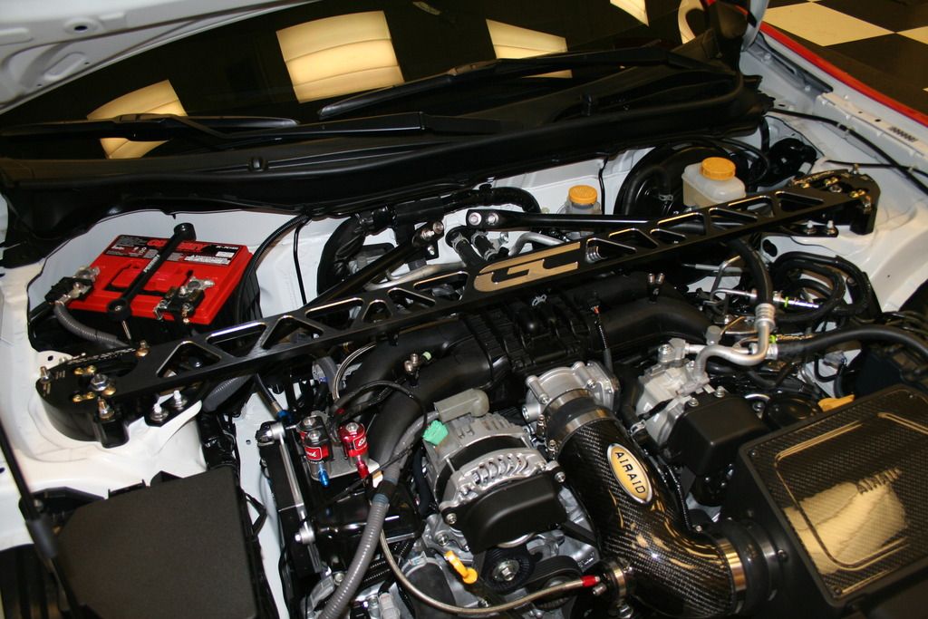

GC posted this picture today of the strut bar.

That's what I was expecting.
Adam: You should post pics of the caster/camber plates for us. (I'm assuming he'll find this thread eventually)
