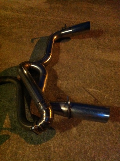

Decided to fab a catback...thoughts?
Here's a teaser pic for now. It's 2.5" stainless, mandrel bends, 4" rolled tips. The goal was to make it simple. So it's just shy of 6' of straight pipe from the flange to the y-pipe. Then two 9" degree bends, some straights, followed by two 30 degree bends to get the tips out straight. It's all one piece so I didn't have to mess with leaking gaskets. May add a vband in the future. As well as a muffler cause its loud. lol. What do you think? Does it look like every other exhaust?

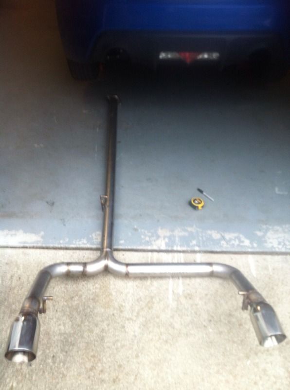

Here's the axle back that was on it first.
I would like to hear it, i am curious now.
Looks good

This one has about $200 in materials with no muffler or middle flange, and low quality tips. Took me about two 5-6 hour days or so to build. It takes me some extra time as I do this in my garage with a jack...and it's all TIG welded.
Realistically, I expect to have around $300-$350 in material costs to get it where I want it.
My goal was simple, light, and cost effective. I'm not a fan of all the exhausts that run two extra resonators before the tips. It clutters it up too much for my liking, and can look a little bulky.

Im liking the simple design, really curious to hear it especially with no resonator or mufflers. I think the single wall tips the you have on the axleback look better though.

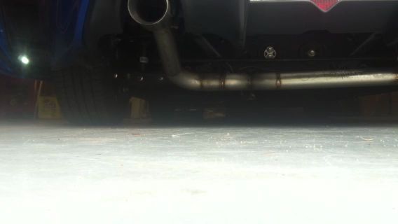

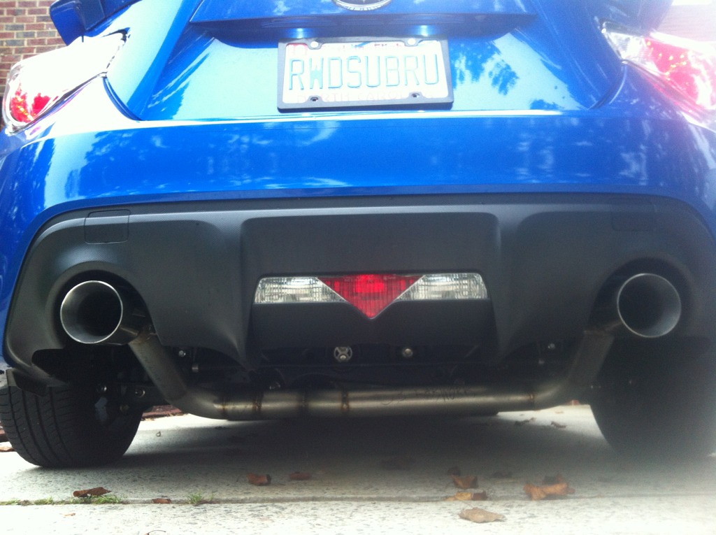

What it looks like:
What it sounds like:
I've now added an inline muffler since this video & picture. Still overall same sound as what it's like in the video. Just less crackly.

Originally Posted by NotSoJDM View Post
What it looks like:
Damn! Nice....is it just me, or the passenger side looks shorter? I know that you mentioned a few things on your to do list, but it didn't correlate to the length of the passenger side exhaust tip. Either way, very interested in the end results. Hell, i'll take an un-polished one to save ya the labor hours.
