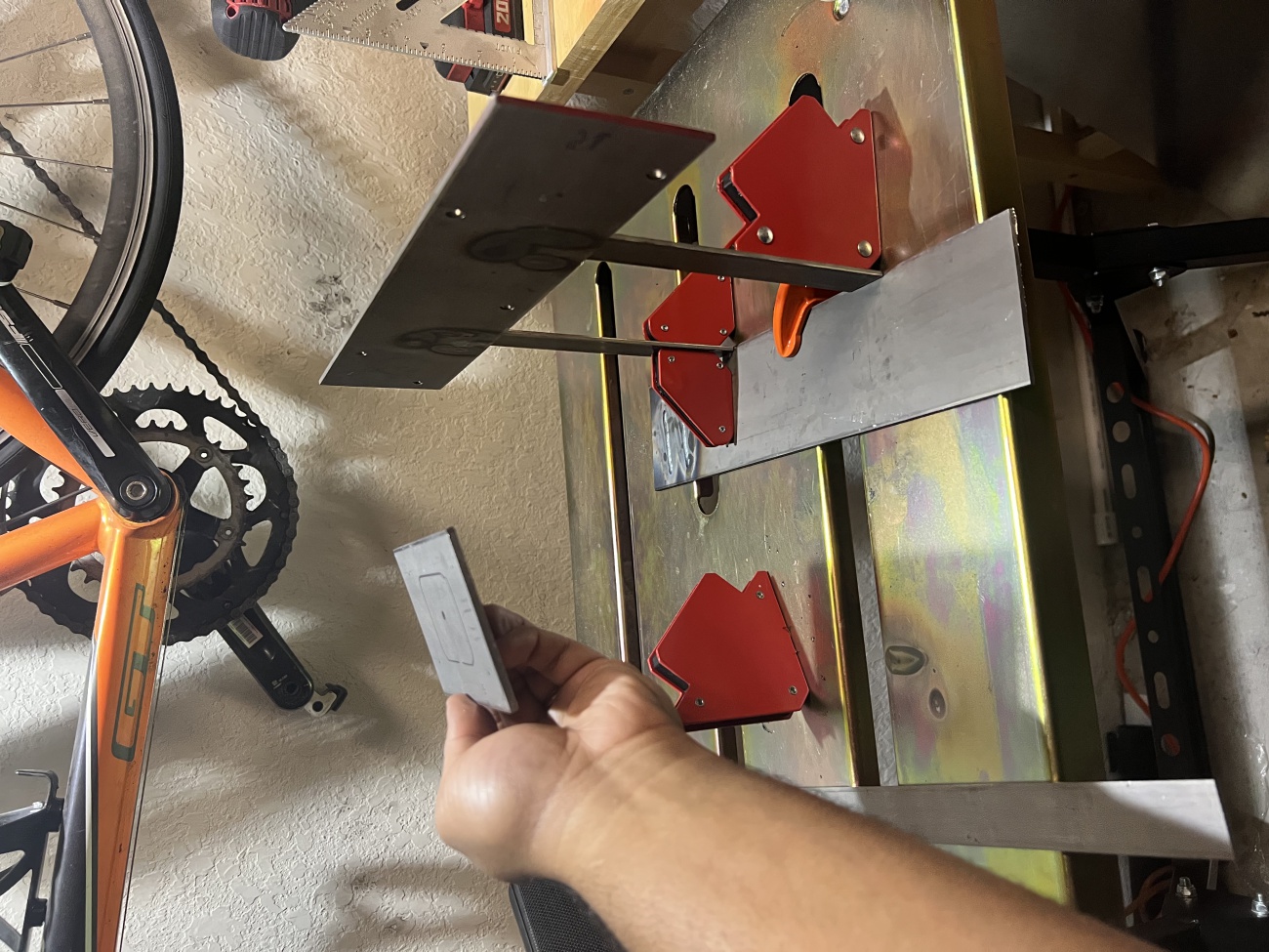

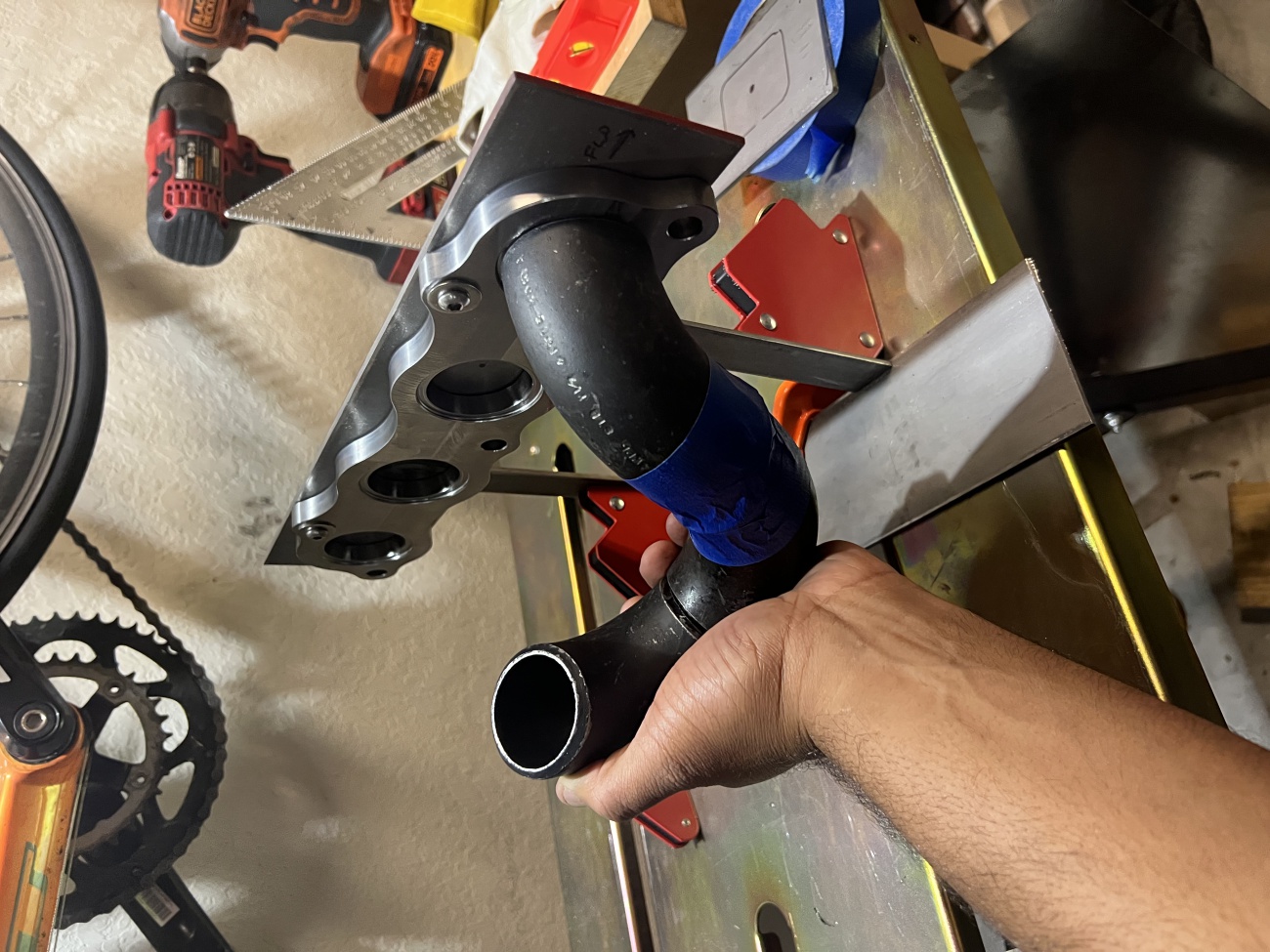

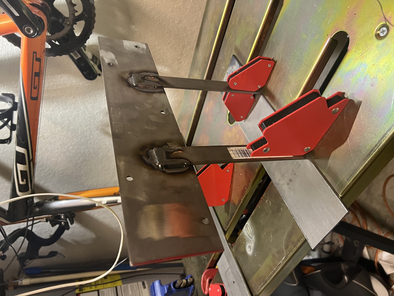

Scored a few tools I needed today, and got started rouging out a jig for my turbo manifold.

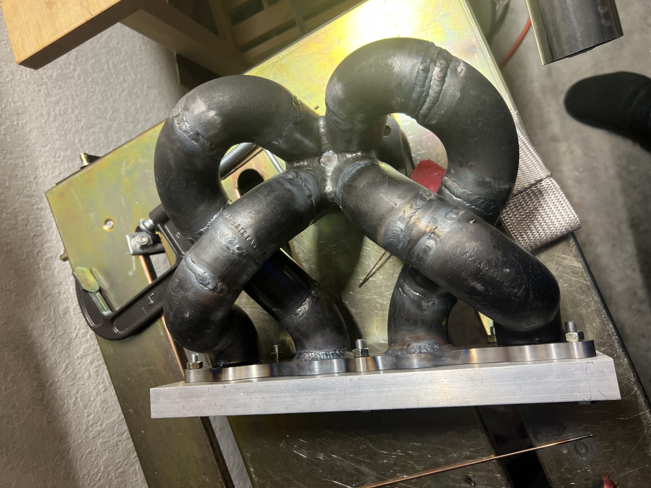

I’ve completely dropped the ball on updating this, so, I’ll catch it up. Finished building the manifold, learned a lot in the process. I’ll likely build another manifold out of stainless one day, but I’m happy with this especially as a first effort.
