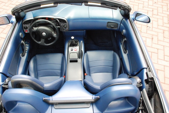

This is more subtle but it reminds me a lot of the colored interiors that Honda did with the S2k.
