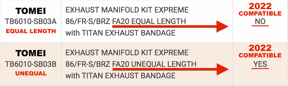

Exclamation EQUAL Length Headers designed for 1st Gen NOT IDEAL for 2nd Gen
New EQUAL Length Headers are being developed for the 2022 model
Engine Harmonics are different between 1st and 2nd Generation
EQUAL Length Headers designed for 1st Gen are NOT IDEAL for 2nd Gen
They WORSEN the Torque Dip and will most likely hurt tuning potential
Unequal Length Headers ARE compatible between 1st and 2nd Gen
Verified Independently and by some Manufacturers

Well yah, but to be fair the Tomei EL headers weren't really optimized for the FA20 compared to others available.
