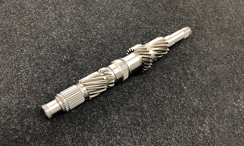

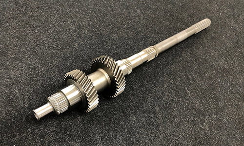

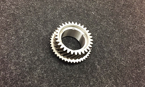

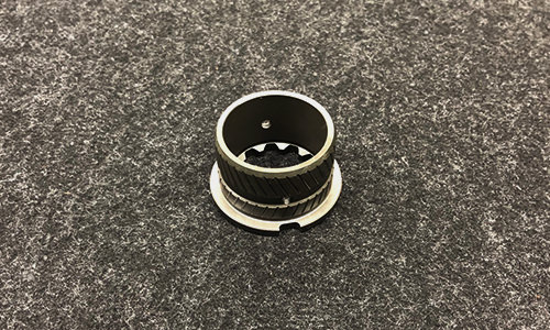

Toyota Gazoo Racing announced some gear upgrades for their domestic 86 Competition parts.
https://toyotagazooracing.com/jp/gr/grparts/ (you have to click on "86 Race Parts" in the menu in the middle of the page.
It looks like all 4 parts are needed, but it's a strengthened output shaft, counter shaft, and 4th gear? Not sure why 4th gear exactly needs to be replaced, the notes below says that the gear ratio isn't changed.
-alex

4th gear is known to get destroyed with FI cars.
Mostly (to my understanding) 1-3 are triple cones and much sturdier than the 4-6 which are single cones.

Can anyone who has shredded transmissions with power (not drivetrain shock) confirm that 4th is the one that goes? It makes sense, since at that speed, it probably experiences the highest load and 5th and 6th are less likely to be run out unless someone is doing a mile sprint or a 140MP+ run.
They actually upgraded 6th gear to be a bit beefier in the '17 cars as part of OE upgrades. But it's not just about power, if you are using sticky race tires, then it puts extra load/shock through the entire drive-line assembly as well.
4th gear takes the most beating of the smaller gears, for track-use. That's why they are shredding them in road racing applications with 200whp levels...it's a combination of a little more power, sticky tires, and load on 4th gear, as 3rd and 4th gear are the most used at any race track.
Makes the most sense. I'm curious more as to how often 2nd or 3rd are sheared during acceleration with drag radials, or if 4th really is the weakest by design all around. This would stop a lot of CD009 conversions if there was a great 4th gear replacement and the gear shearing incidents could be isolated to only 4th 5th and 6th.
TL;DR I want to know if 450wtq with drag radials will break axles before gears if I stay in 1-3.
