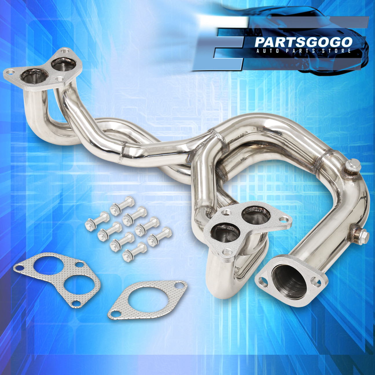

I keep seeing this header all over Ebay and figured someone has purchased and installed. Looks like multiple sellers have over 100+ sales so someone must have used this.
Any one actually make power with it? Looks like an HKS knock off, Godsnow looks like the name on it.
I figure a cheap way to eliminate the cat at least some power with a tune.

The hard parts to get right are the welds and making sure the flanges are flat. The material itself could be subpar.
The shape itself looks...fine, I guess.
What's odd is the hardware. They show 8 nut/bolt pieces in the photo. But you can only use 2 - for the overpipe flange. The other 6 holes on the header are for the studs on the head, which, even if you removed them, you could not use a nut & bolt.
They also show fill plugs inserted into both O2 bungs, but that doesn't make sense. You would need at least 1 O2 sensor for the closed loop feedback.
Both O2s aren't just for emissions BS lol
As far as answering your question about making power, it probably does. The shape looks about as free-flowing as any other. Assuming the interior is smooth (not any sloppy globs of weld causing turbulence), and it doesn't leak, then it might be the same, on paper, as any other header. But that's only if it mates tightly, and nothing leaks.
Even then, it's just a question of longevity. How long until a weld breaks off?
Even on reputable headers there are occasional issues with craftsmanship.

You get what you pay for.
Will it last? Not for long.
Is it well made? It's a hit or miss.
Will it fit the first time? You can hammer to fit.
Will it get you the 50hp you think it would come if it? Not really.
If it was me, I wouldn't even bother trying to get any more hp from tunes or exhaust mods. I'll just pay for any supercharge/turbocharged kit if I really want useable power not sounds like it has power.

There is a reason why it's so cheap. With stuff like this you HAVE to expect fitment issues and possible weak welds, corrosion. If you're fine with that and know how to deal with it it should work fine combined with a tune/reflash.

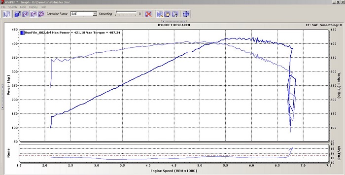

I found a review of that header and a dyno run. The article said regular fuel and a tune so I think you should get one and let us know if you get similar sort of gains.
Link

I'd say you can expect some gains with this cheap ebay header. Probably on a par with HKS or a de-catted OEM header. They are all 4-2-1, same runner sizes, etc.

I use cheap parts but I wouldn't get a cheap header. Problem with them is they can't withstand the thermal cycles.
It gets hot, then it gets cooled or water splashes onto them. I've seen too many cracked headers. Have to make sure the flange doesn't warp or is straight.
Then the hardware kit, a lot of frustration diagnosing an exhaust/vacuum leak. Could be the flange not sealing right or the gaskets.
