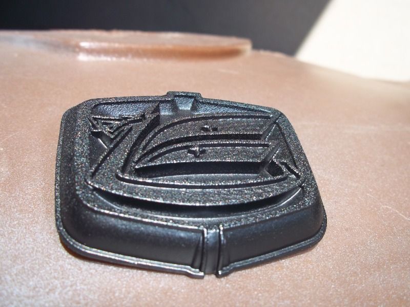

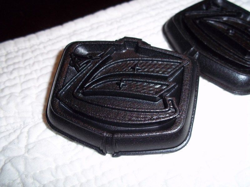

This!!!! Also when you spray it on make sure the coat has a nice thick shine to it. when i did mine the first time each coat would get bubbles in it then dry porous and if i made it a bit thicker it would dry nice.
Sorry for the huge images. As you can see from mine they are still kind of porous and could be better but they still look pretty good. remember that this stuff is kind of like rubber and it might be better to take the extra time and use actual paint.
