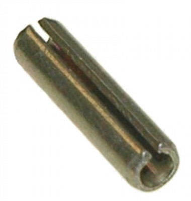

Keep in mind the pin is a roll pin (also known as a spring pin), which is spring steel that is not a complete pin. There is a split on one side and a hole in the middle. You compress the pin to keep tension on the joint and keep the pin in place.

Yep. Use a 3/32" roll pin punch (has a small bearing on the end).
It is best to use an actual punch. If you try and knock it out with something that is close in size but not quite right you might flare the pin and then you have to drill it out. I bought a cheap one on amazon and it did just fine.

I use a 3 mm socket head cap screw to drive it out. They're a common hobby store item. Screws right into the plastic. Easy peezy & no trauma.

This makes sense. Mystery solved. Thank you.
Brilliant! It did the trick.
