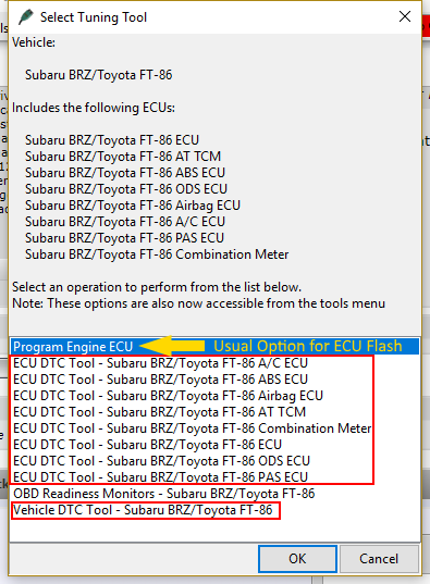

Got a CEL today, car drives fine, how do I get the code via ProECU? Does the code automatically pops up when I connect the ecutek cable and identify the car? Further more, can ProECU clear the error code?

It's really simple, a quick look at ProECU and you'd have found it.....
Either detect the ECU as if going to flash it or select manually:
The bottom option in red will give you any DTCs. The upper options are for if you know which ECU is throwing a code.

thank you, exactly what i was looking for
