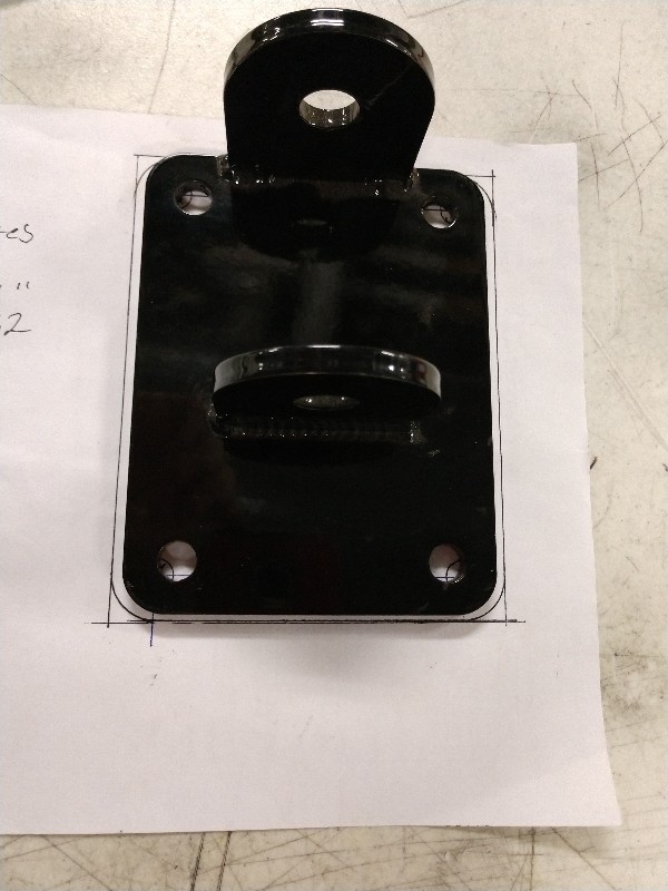

I drew up the design for the plate just need to make it now.
Vorshlag plate in picture center to center on the holes is
4 13/32" X 3 3/2". That was what I got anyway.

Vorshlag plate set on drawing. Not to far off but not enough material to modify it
