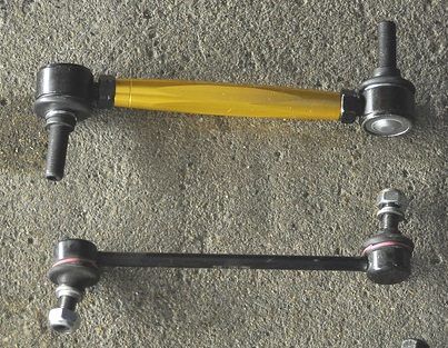

OP: Did your Coilovers come with replacement End Links? (Mine did... not same brand as yours...). If they didn't, and you're using the OEM End Links, it's possible that there could be some level of noise from the EL but... it would be more of a "chunk" noise.
Based on your description of the noise and when it happens, I'm also going to guess that it's "Coil wind." I added some Torrington Bearings (i.e., replaced the upper perches) so that as the springs "wind," the Torrington Bearing(s) would move with the "wind." A set bought online ran me $100.

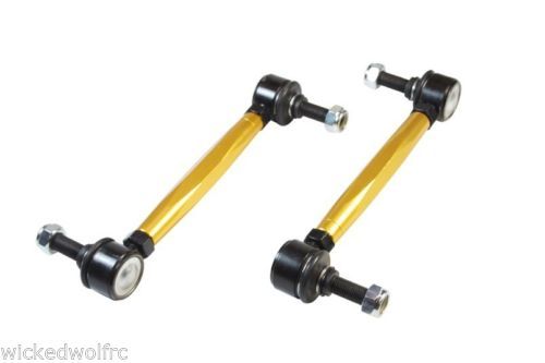

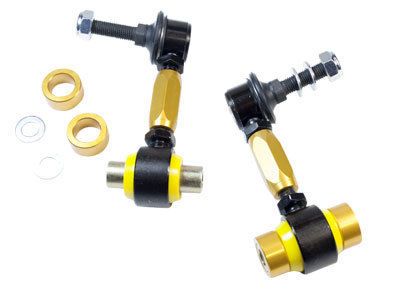

Back to End Links... I recently had to replace my front End Links (the ones that come with the Coilovers...) and went with White Line KLC 179. I also then replaced the OEM rear End Links with White Line KLC 182. IMHO, a significant (better) difference with the beefier links. In the front, a new-found firmness in steering and when turning-in, very crisp as the beefier links work better with the OEM sway bar.
And in the rear, there was a little of what I'd call "squishiness" (or some call "squatiness) when accelerating. All that is gone now... there sure seems to be a better delivery of power to the drive wheels. This rig has always put a smile on my face... the smile is now larger over the last week with this new-found improvement. (Cost about $400 in parts and labor to upgrade to the White Line links.)
Install note: After initial install and putting on some miles, go back and have all install nuts and the nuts that help set length (adjustments) checked for tightness! Torque those puppies down! (Don't ask how I know to recommend this... chalk it up to NVH.)
