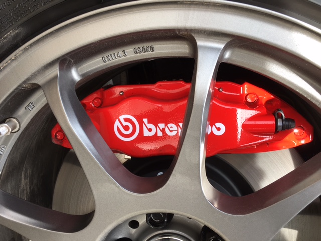

Uploaded picture for Future reference.
Hope OP doesn't mind

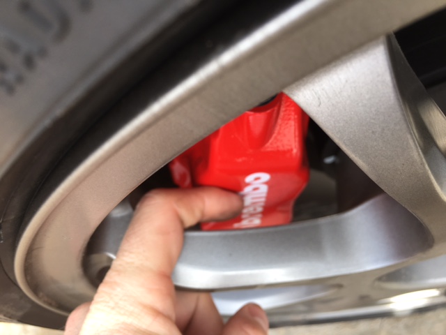

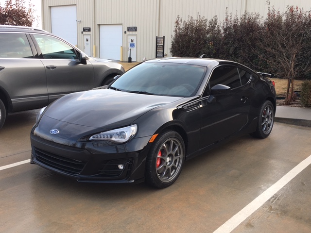

Just FYI, Kosei K4R 17 x8 fit just fine. I run these with my All Seasons on.
Pics for reference. Just sharing info.
http://www.ft86club.com/forums/attac...1&d=1488921841
