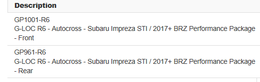

They should be the same size as the STI, but I could be mistaken or at the very least be missing a small detail. However, I apurchasing some G-Loc pads from Counterspace Garage. @CSG_Mike should be able to help you with any pad questions.
Here is how mine comes across on the invoice.

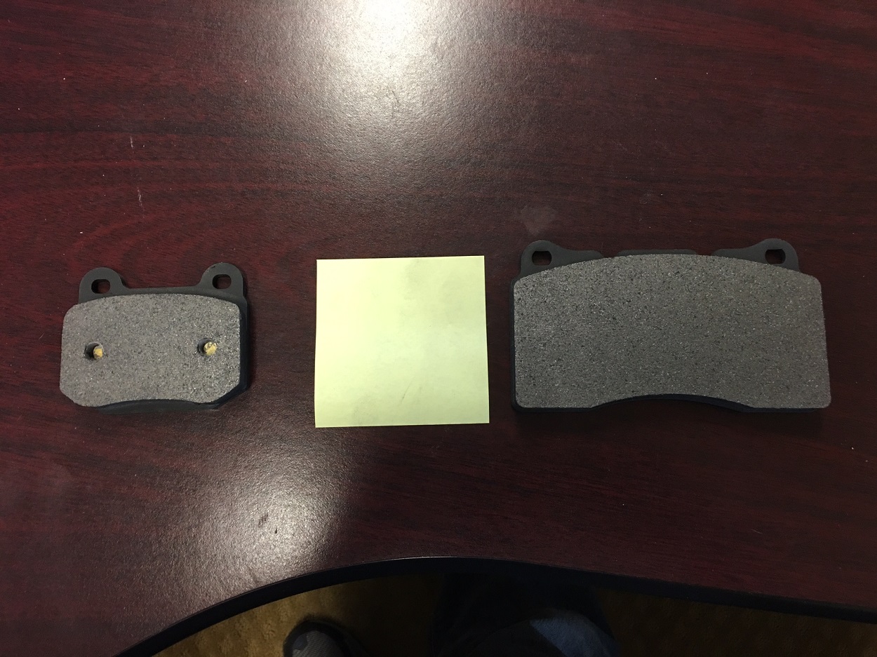

Here is a shot of my G-Loc R6 pads for the PP brembo kit.
@mjanmohammad

Just got off the phone with Mike and he suggested entry level track R10 compound pads from G-Loc for track day usage, and said they should work fine for AutoX as well.
