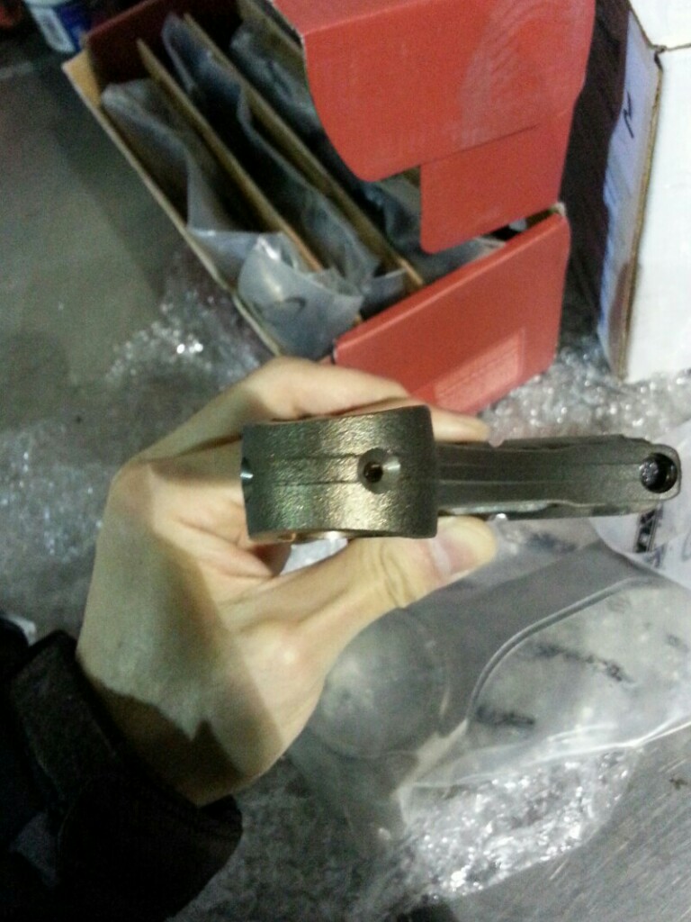

yes. every rods in the aftermarket not fit to stock piston.
you should machine rod's small end or you can ask to manufacturer to make rods for stock pistons.
LT one is OE rod for zn6 , Rt one is aftermarket (skunk2)

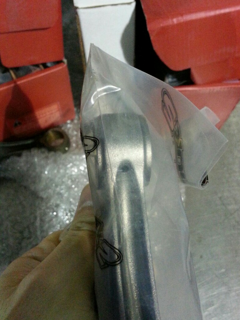

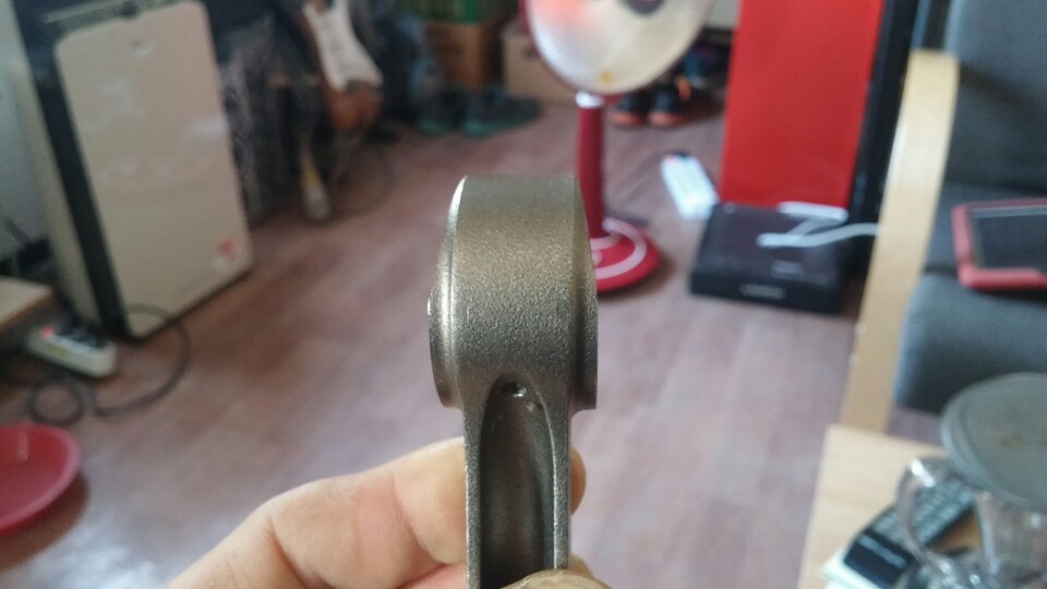

Originally Posted by makinen View Post
One thing I have missed is thr tapered small end of stock rods and matched stock piston pin area.
Attachment 131637
Attachment 131638
But Skunk2 rods have this shape.
Attachment 131639
So I have to go to the machine shop to match the stock pistons.
Attachment 131640

yes you need to machine 90% of the rods on the aftermarket to fit the stock piston
for some reason the aftermarket designs have yet to catch up with the oem trend of a thinner top strap
