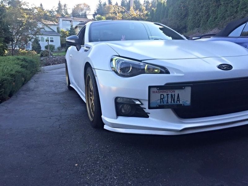

No picture of the hardware, so here's one of the car. Cheers
