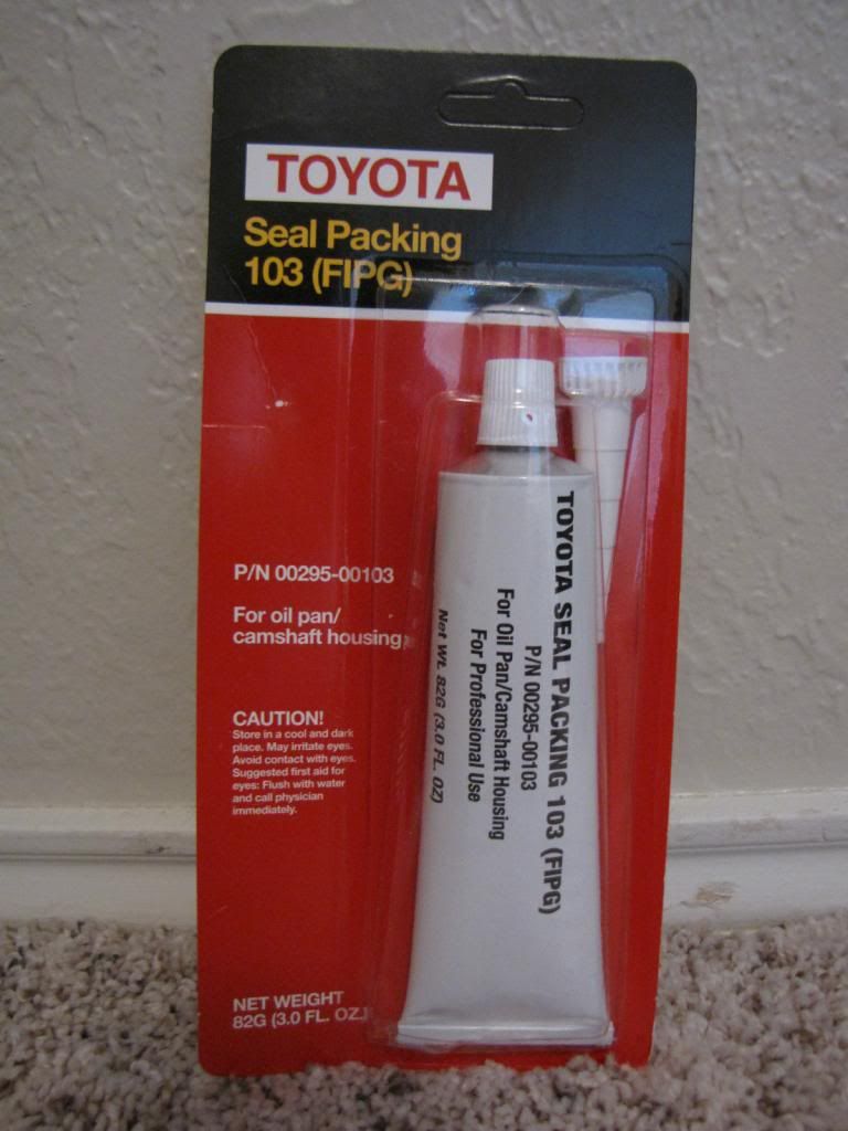

While it does suck that you are without your car, at least you can take credit as being one of the main causes of this issue hopefully being resolved at the assembly level, and as a future owner, I owe you a debt of gratitude and a drink for your troubles...:happy0180:
Okay, I got it fixed at the dealer today. In my original post I mentioned that Toyota Corporate got involved. They did not end up sending anyone but just told the dealer to just fix it.
Below is how the dealer logged my issue into their system.
Guest states clinder (sic) head plate on the passanger (sic) side is leaking; guest smells like burning oil.
Below is how they stated they fixed it.
Story: 6956 Poor sealing of cylinder head rear plate 110991 170 Removed plate and re-sealed. TAS Case #130630442
The parts used for the fix is: 1 FIPG Oil Pan
I did some internet searching on this sealant and people seem to like it better than the RTV and the Right Stuff being referenced in this thread. All I know is this is what the dealer used.
Here is a picture of FIPG
Thanks for the detailed post and follow up, very very appreciated!

At the risk of stating the obvious: Since Toyota makes cars, not sealants, the Toyota product, while undoubtedly good, is probably made by someone else — maybe Permatex. The label is Toyota, and the price is Toyota, but the sealant inside is probably not Toyota.
My problem with this leak, and the fix, has to do with the cover plate. It looks like little more than a flat piece of scrap metal. If it had some contours — indeed, if it were fitted to the head, shaped to fit in some way — the sealant and the plate would work much better. A ridge or a caulk "gutter" would help.
The Toyota (Formed In Place Gasket:FIPG) is good stuff. Its used on pretty much every thing that needs a gasket on Toyota's. Head cover is the only thing that has a rubber gasket.
If you do reseal the plate yourself be sure and:
1. Clean the engine side of the seal good. Isopropyl Alcohol is best.
2. Get all the old sealant off the plate. Clean with alchohol.
3. Get the plate on the engine in <5 minutes.
4. Get the plate tightened in <10 minutes.
5. Do not go back and retighten after the FIPG dries. Same as over torquing a felt or rubber gasket, it will crack/break and leak again.
