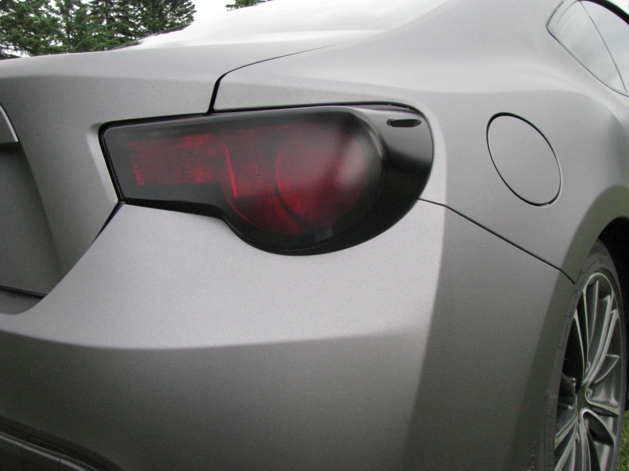

Thanks for the DIY
Followed it with the results below. I did smoked outside, with a red with smoke in the center. This is my attempt at FRS concept-like tails.
Could be clearer, but happy with them. Might try to add some coats of clear.

Thanked 327 Times in 154 Posts
Man I hate to be a **** but you've made your car a very neutral color that is easy to lose in many environments and lighting conditions, a finish that is very flat and non reflective, you've smoked/tinted your primary and third brake lights to the point their output is surely very diminished, and you've essentially neutralized all retroreflectors on the rear of the vehicle.
I've seen many people get seriously f'ed up due to high speed rear end collisions which you are now at greater risk for, stationary or otherwise. If you ever have to pull the car to the side of the highway, put your flashers on and abandon it until a wrecker or motorist assists arrives. I'm dead serious. Based on the wrecks I've been to it's a good idea in general and with a car like that pretty much a requirement.
MmmHamSandwich is offline   Reply With Quote
Wouldn't call you anything, it's just an opinion and thanks for it. Side reflectors yes I do agree were compromised, but the rest is just fine. Easy to see day or night, the tails are no darker than the last blazers or grand prixs.
Im wiring the forth brake light today.
I appreciate the concern, and so does my mother. lol
